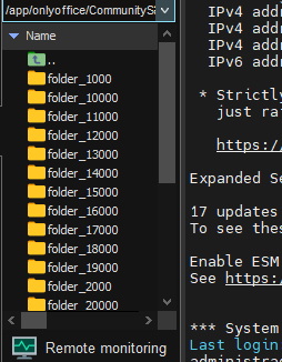

Good morning, is there an intuitive way to locate folders and files stored within the server? While connected via SSH to the server, I believe I came close to where the files are located, but the nomenclature isn’t helpful; the names of the folders and files on the web shouldn’t be the same as those stored on the server. Is there a way to find them? I noticed that when clicking on a folder in the URL, there’s a number, but this number doesn’t match on the server. Below are some screenshots to better illustrate what we’re trying to locate.
Path: /app/onlyoffice/CommunityServer/data/Products/Files/00/00/01/

Folder hierarchy on the server is not related to the folder hierarchy in the Documents module.
I need to recover a folder that was deleted. I have the VM backup, and I can view the files through the file explorer. [Note: Platform backup was not enabled, so I don’t have a backup through the platform.

That means you have only two options.
  • If your whole server backup\snapshot contains the file before deleting, you need to rollback entire server to this state and get the file (ask the file owner to log in to the portal when the rollback process is finished and to share the file with you).
  • if you don’t want to rollback the server or file owner don’t want to share the file, then nothing can be done here. Removed files are not located on the server.
