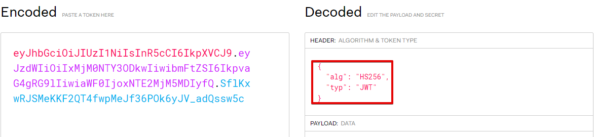

Hi, please provide an example of your token.
You can also check the encryption algorithm by pasting your token at jwt.io.
Document Server requires the token to be generated with HS256 algorithm.

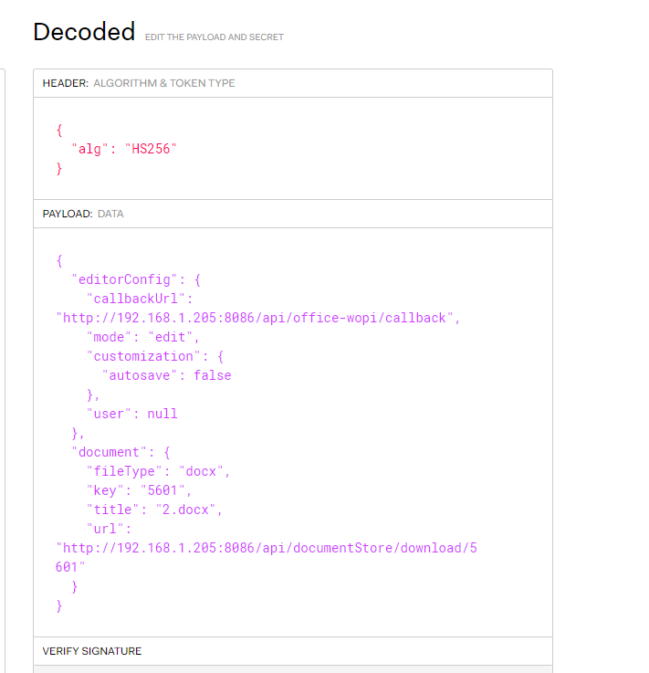

Hi, thanks for the reply.
The decoded token at jwt.io looks like this
Please change the token header so it also contains its type:
  "alg": "HS256",
  "typ": "JWT"
Let me know the results.

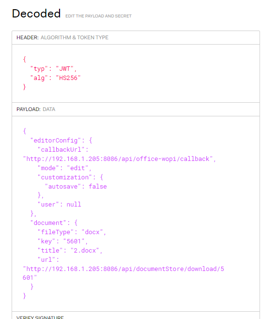

I changed the token generation, so that it includes the “typ”.
On jwt.io it looks like this now.
Other then that, the error is still present.
