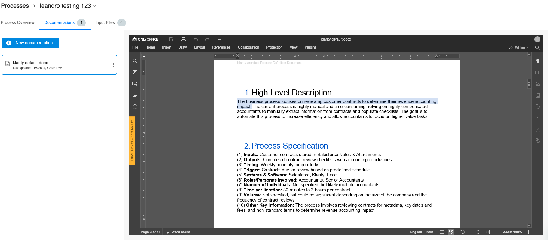

I am using the @onlyoffice/document-editor-react package in my react web app like in the below screenshot, my question is if there is a way to get selected text data (like in the screenshot) outside the iframe, ideally to me you should have something like this where I have an event to get selected text data:
<DocumentEditor
onSelectText={() => {}}
// other props here
Follow up question: if this is possible how can I modify programmatically document text inside onlyoffice from outside the iframe in my react web app
Thanks!
