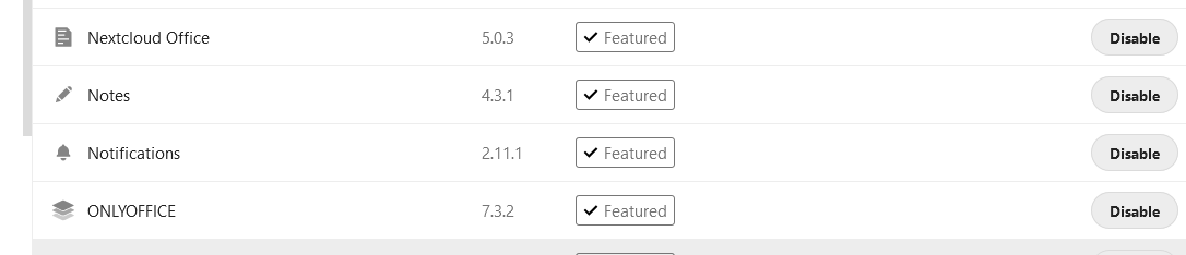

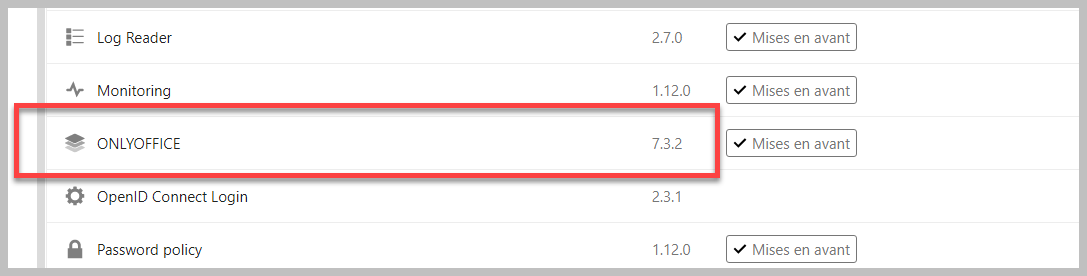

The connector app version is in your applications directory in Nextcloud. Just in right of OnlyOffice you’ve got the version
Hi @Irwin/@Alexandre
Thanks @Irwin for the help, please see the connector app version, in attached file.

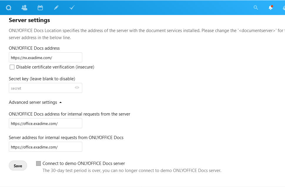

Hi @sushant
Judging by the screenshot you posted on Github, you’ve entered the same address for the Document Server and Nextcloud in the Advanced server settings in Nextcloud. That assumes that Nextcloud and Docs can reach each other via the same address, which is, of course, not the case.
You should try to either leave both of the Advanced server settings fields empty or enter the Document Server address (office.exadime.com, I assume) in the first one and the Nextcloud address (nx.exadime.com) in the second one.

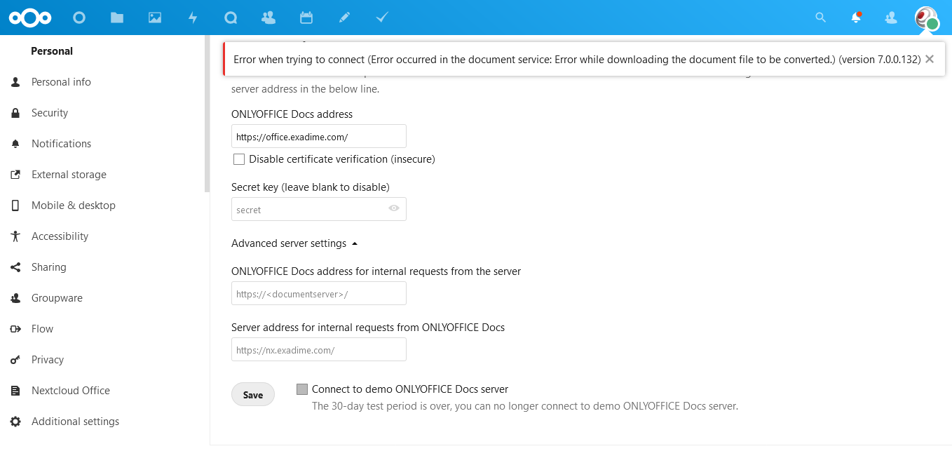

Hi @Serge
Thanks for the reply.
Are you suggesting like this please see attached pic, if I m wrong then correct me please .
Hello @sushant
No, nx.exadime.com is your Nextcloud portal address. But you set it in the first field (DS field).
Please set Document server address in the first field as @Serge mentioned and click Save button. Please let us know the result.
As for other fields, please try to leave them empty.
Hi @Alexandre ,
Thanks for the reply, I tried as you suggested please see the below pic for reference.
