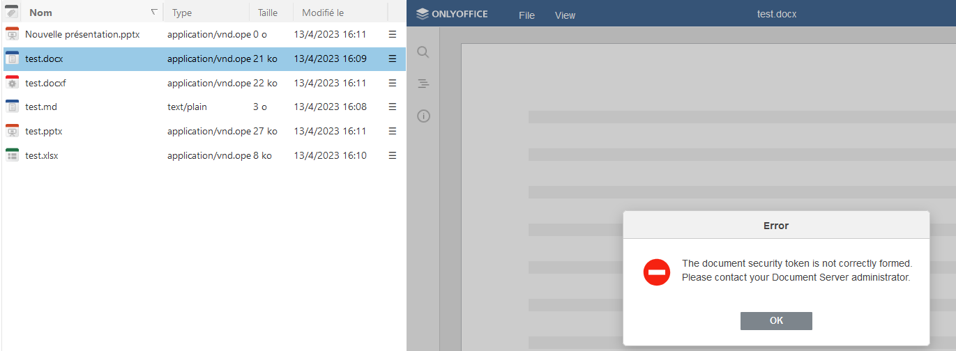

For bug reports, provide the steps to reproduce and if possible a minimal demo of the problem: I have integrated onlyoffice with nextcloud and everything works. There is a link from nextclouyd to zimbra to be able to make links, but I can’t modify the files, an error message tells me that there is a problem with my security token on all the files (no matter the file extension, I get an error message), but I don’t know where to enter my password

Am I correct in understanding that the document opens correctly through the Nextcloud interface, but the same document opens with an error through Zimbra?
Could you please provide a video recording of the issue being reproduced?
yes with nextcloud the document opens perfectly.
But with zimbra I have an error message (there is a link that was made from nextclouyd to zimbra)

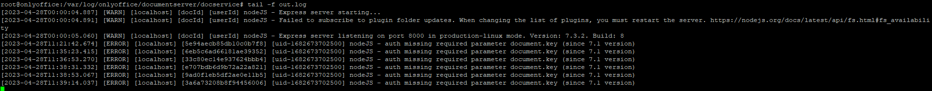

In order to understand the reason of the issue, please also send us the archive of the folder with all Document Server logs /var/log/onlyoffice/documentserver/. Please check also Nextcloud log after you reproduced the issue and send it to us, if there are any errors.

Here are my logs when I try to open a file in zimbra with onlyoffice
