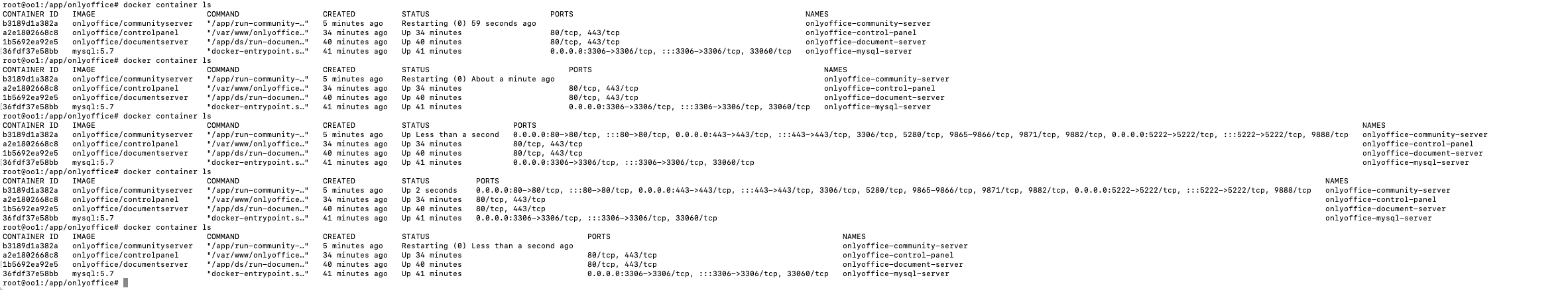

Communityserver is restarting every 60 seconds:
