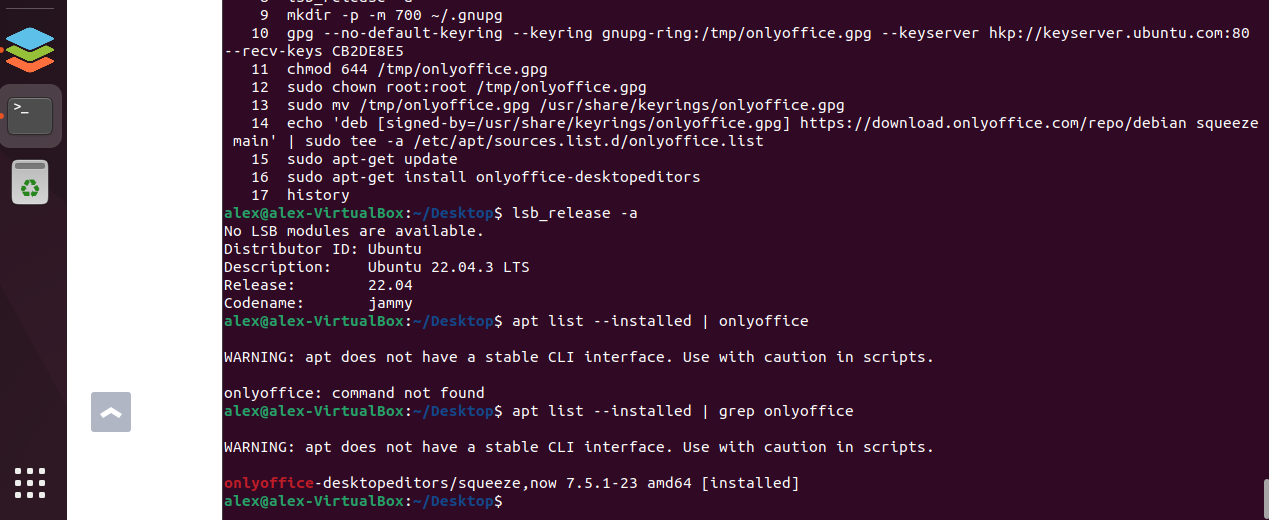

I just have checked it on my Ubuntu 22.04 PC, all things are OK:
As a possible solution, please update your OS (apt update, apt upgrade commands) and double-check the situation. If the issue still persists, please provide us with a screenshot from terminal with the issue itself (reproduce the situation).

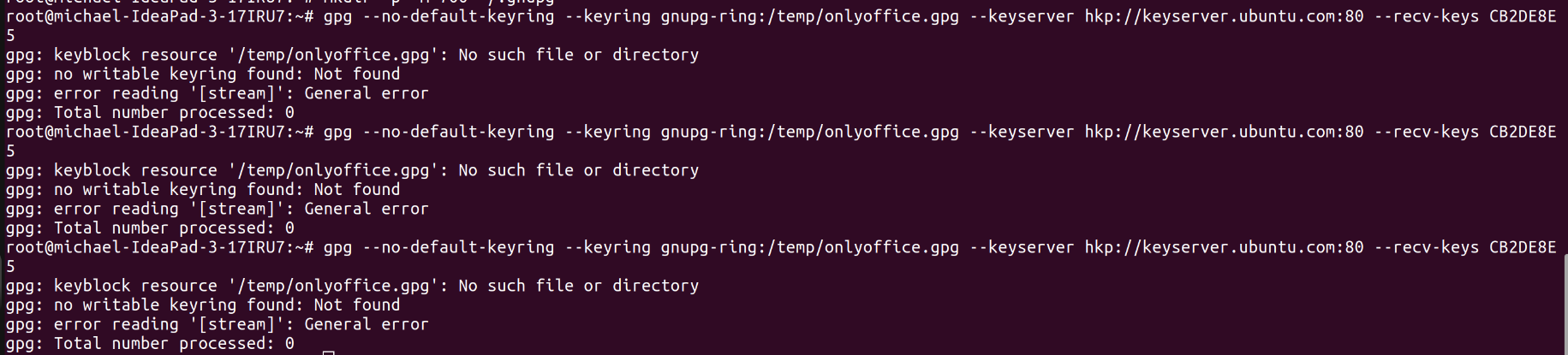

Here’s what I got this time. When I got the first message that no such file or directory as \temp\onlyoffice.gpg existed, I went back and downloaded the deb package and extracted it to /temp, but that didn’t work either.
Thank you for the screenshot, we are looking into it.

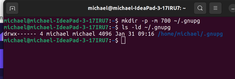

Hello @profe_miguel
Would you mind running a test? Please run the first step from the guide (folder creation - mkdir -p -m 700 ~/.gnupg) and after that please check if this folder was created: ls -ld ~/.gnupg
Please show us the output result.
Here is the screenshot:

Hello @profe_miguel
The strange thing is that ls -ld ~/.gnupg output result is correct, but your previous screenshot described that folder wasn’t created. I assume that the issue is related to your PC only. If it’s possible, please try to check the issue on the separate fresh installed Ubuntu.
