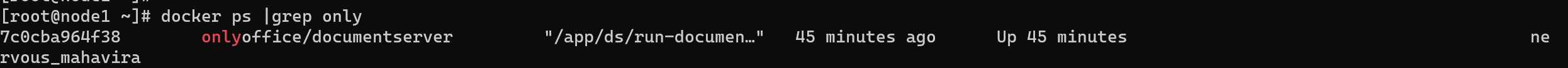

it look like no network port is listening

thanks, I add the “–net host” option and solve the problem.
