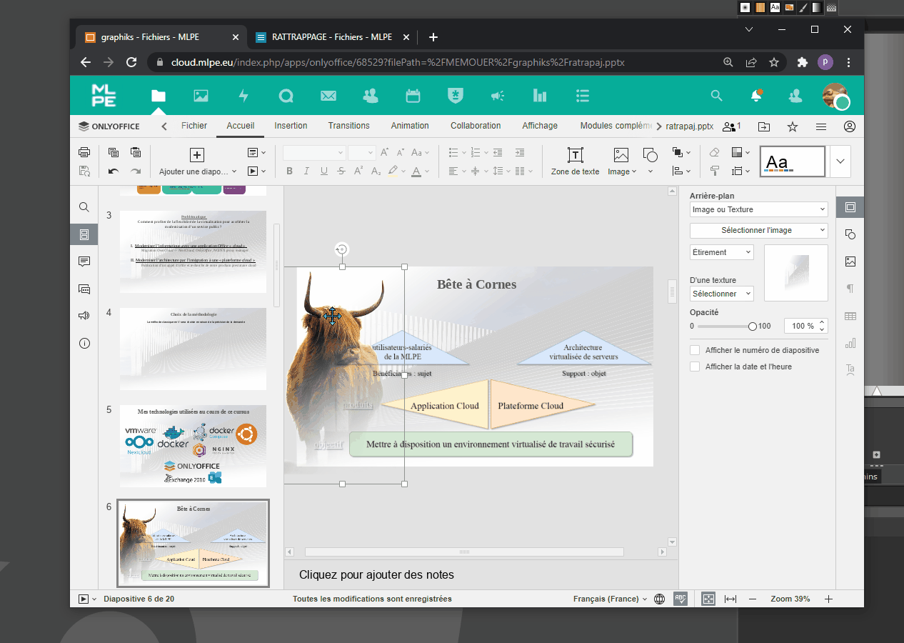

Hi @Farkhod,
of course, here are some inputs made with Screen2gif
I first recorded with Chromium, then Brave, then Chrome on another computer (rdp involved)

openOO3
ps : sry i’ve been kind of struggling with this capture, I wanted to put a maximum of infos in a few images, there are cuts.
