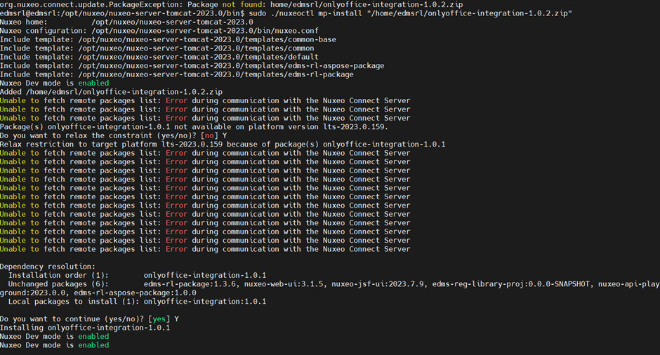

I have Nuxeo Es5 in localhost version as 2023LTS, But onlyoffice which is 2019 LTS,. When installing the zip in unix command im facing error like version conflict, and powerstart up error. Is there is any solution to solve this

Hello @Hari2320
Unfortunately, package that you are trying to install (version 1.0.1) supports version 2019 of Nuxeo. Latest version 2.1.0 of the connector supports version 2021. We are working on the new version in which support for Nuxeo 2023 will be included.
ok thank you for your reply, May i know when the 2023 version will be released
Currently there is no exact ETA, but it is planned for the Q2 of 2025.
