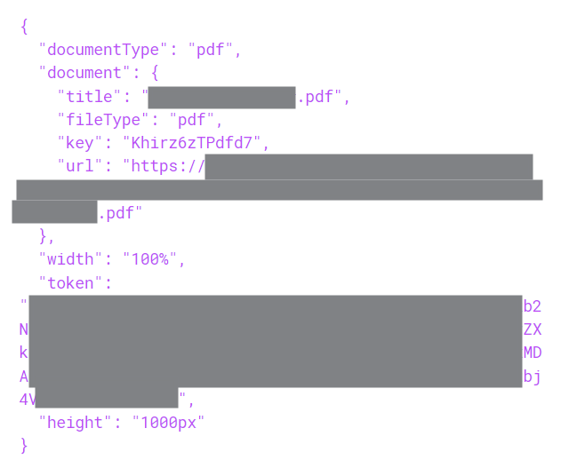

When I decode the token using https://jwt.io/, it shows the following output:

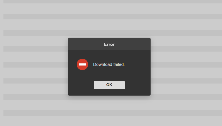

The issue I initially reported was caused by the secretKey being transmitted after base64 encoding. After resolving that, I am now encountering a different error.

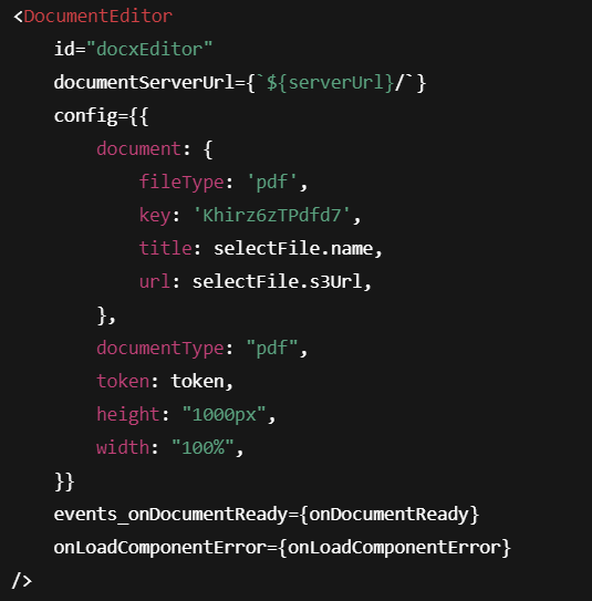

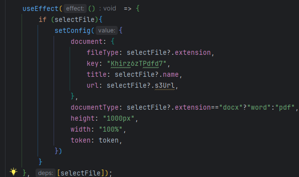

I am providing a publicly accessible S3 URL, and the config structure is as follows:

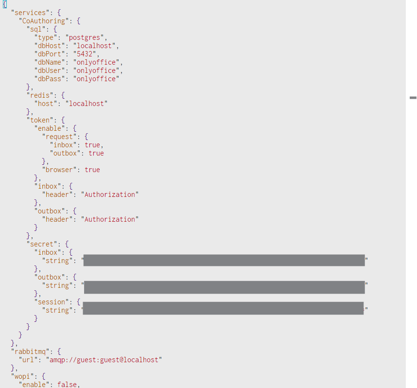

The contents of local.json are as follows:

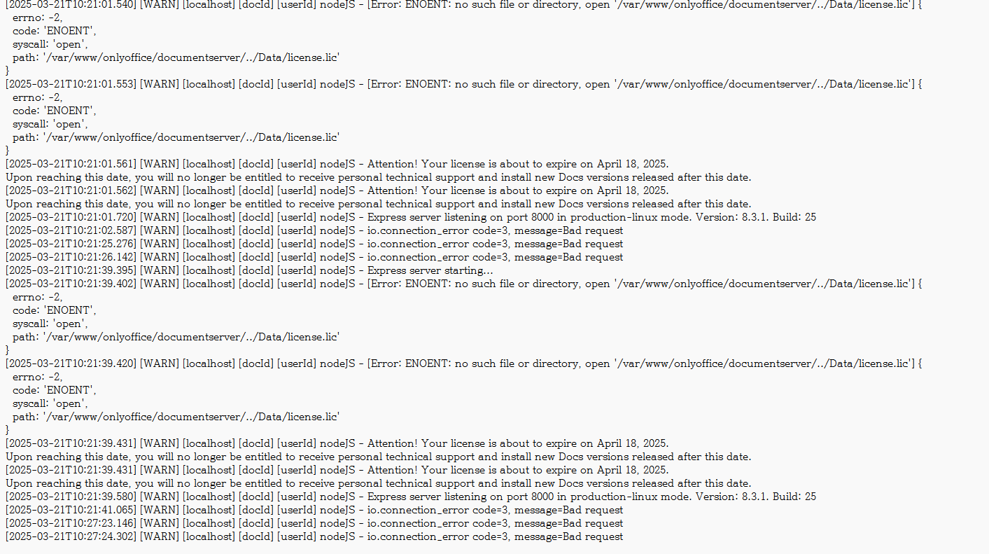

The out.log file from docservice contains the following log entries:
Is there anything incorrect in my code?

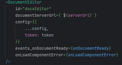

+) Additionally, I am using the DocumentEditor component as it is, imported via:
Hello @moonjb,
S3 bucket cannot be used as file storage as it is (although it can be configured as the cache storage - Connecting Amazon S3 bucket as a cache to ONLYOFFICE Docs)
To be able to use it as file storage, you’d have to build additional layer, we have only C# example of integration with S3 as file storage, here it is - document-server-integration/web/documentserver-example/csharp-mvc at feature/csharp-mvc-s3 · ONLYOFFICE/document-server-integration · GitHub
Also, the logs indicate that you have a commercial license, which is about to expire. Please contact your sales manager at sales@onlyoffice.com. If you have a commercial license, you can create tickets in the helpdesk and ask questions there
