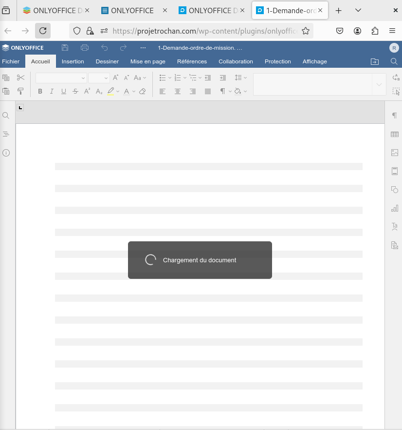

I can't open a document from my wordpress site
Hello, I installed onlyoffice docs on a local debian virtual machine (I followed this tutorial) :
https://helpcenter.onlyoffice.com/fr/installation/docs-community-install-ubuntu.aspx
Now I would like that when I open a document on my wordpress site that we can only view the document (with the ability to download)
However, when I try to open a document, it loads endlessly. A screenshot :

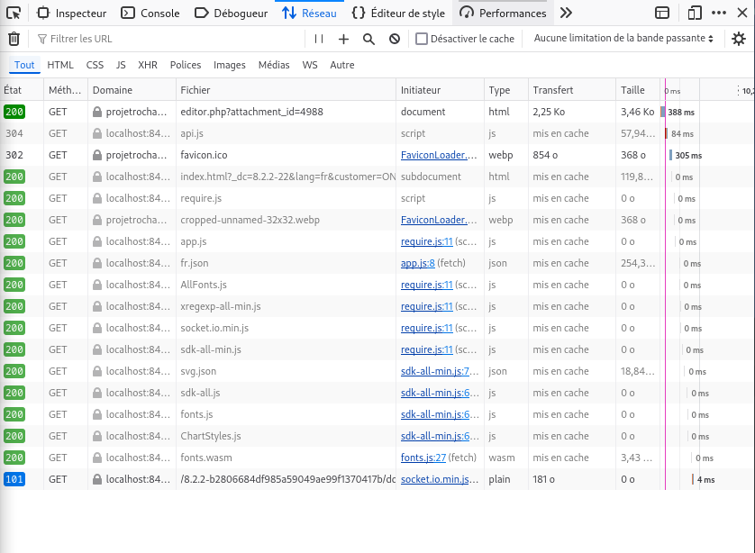

Please provide the following additional info:
  1. Document Server logs (/var/log/onlyoffice/documentserver)
  2. The screenshot of browser’s DevTools → Network tab when reproducing the issue (F12 for Chrome/Firefox)
  3. Version of the Document Server that you integrate with Wordpress
  4. Wordpress version
  5. Onlyoffice Connector’s version
  6. Onlyoffice Connector’s settings within Wordpress ( administrative dashboardONLYOFFICESettings)

How can I see my version of Onlyoffice docs?
Actuellement j’ai le version 6.7.1 of Wordpress
Please avoid using localhost as Document Server address, install Wordpress and Docs on different machines.
After doing so, please provide new logs as file (/var/log/onlyoffice/documentserver, for Docker - inside the container, we would need to see all the logs)
For the version check, please provide the output of the following command: apt list --installed | grep onlyoffice
Do I have to install onlyoffice on a different virtual machine to get it to work?
It is recommended to have them installed on different machines, please try and share the result with us
Do I have to install it with docker?
You can choose any of the available installation methods: package installation, Docker installation on a Linux-based machine, Windows server installation

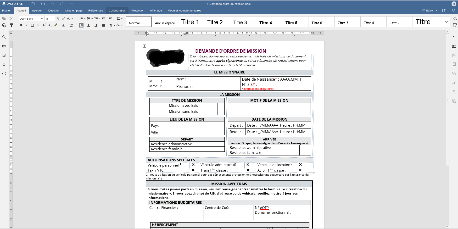

In the end it works, however the plugin gives a link only to edit the document, I would like to have a link to see the document and have the possibility to download how to do?
Please provide the screen recording of the issue. Generally, you should be able to edit and save documents from Wordpress integration after connecting Docs according to the following guide: Integration. Getting Started. WordPress - ONLYOFFICE
There are no “errors”. Now you can edit, and save. I want the user to be forbidden to edit the document. (He should only be able to view and download the document).
Hello @RollsNems,
Sorry for the delayed response. Permission to edit in the Editor within Wordpress depends on the user’s role set in Wordpress itself. If the Wordpress user is allowed to edit files, the Editor opens the file for editing. It is not set on the side of Onlyoffice Connector

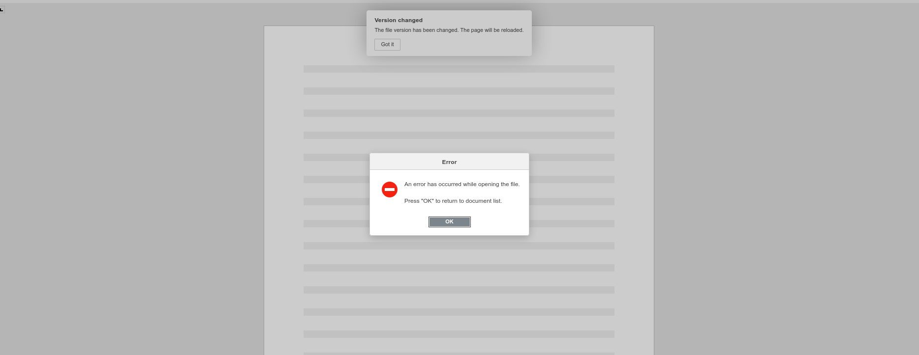

Sorry for the late reply, but I did check and you’re right. However I have a new problem. When I do the upgrade via “sudo pat upgrade” there is a moment the following message:
