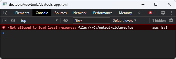

I have a simple Spreadsheet with one hyperlink to an image on my local filesystem.
Path to the image is: C:\output\picture.jpg
So I set the hyperlink to: file:///C:/output/picture.jpg
When I click on the hyperlink, I get the following error:
Not allowed to load local resource: file:///C:/output/picture.jpg
(in Console @ debug mode).
How can I give DesktopEditors access to local filesystem?

Hello @Constantine,
browser throws the same error.

Please run another test and use link as file:///C:\output\picture.jpg
with backslashes and check if makes any difference.
Hello @Constantine,
I tried that and some other variants too and there is still “Not allowed” error.
