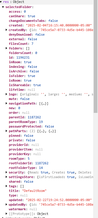

Thanks. I followed the example but createFile does not return the file. It looks like it returns the folder info instead. My code is:
DocSpace.SDK.initManager(config);
                    var frame =  DocSpace.SDK.frames["ds-frame"];
                    const fileName = "Test.docx";
                    const selectedFolder = 1196231;
                    const res = await frame.createFile(selectedFolder, fileName)
and it returns:

To add info, the code I posted indeed DOES create the file, however it does not return the file id, so I can’t open the created file

can you please scroll up to where I posted my code ? The issue is that calling
const response = await frame.createFile(selectedFolder, fileName)
The response as of your documents should have the id of the created file. However the response returns just an object with a selected Folder property, I attach it again here:

Thank you for the provided data! We have found a bug in the described scenario, and we have started working on it. I will update this thread once we have something to share.

We are going to fix the mentioned method in the next DocSpace update (v.3.1.0). The release is planned for 4-6 weeks approximately.
Hello @joer00
The DocSpace v.3.1.0 has been released. This release contain a fix for the mentioned issue in this thread.
It works , thanks
