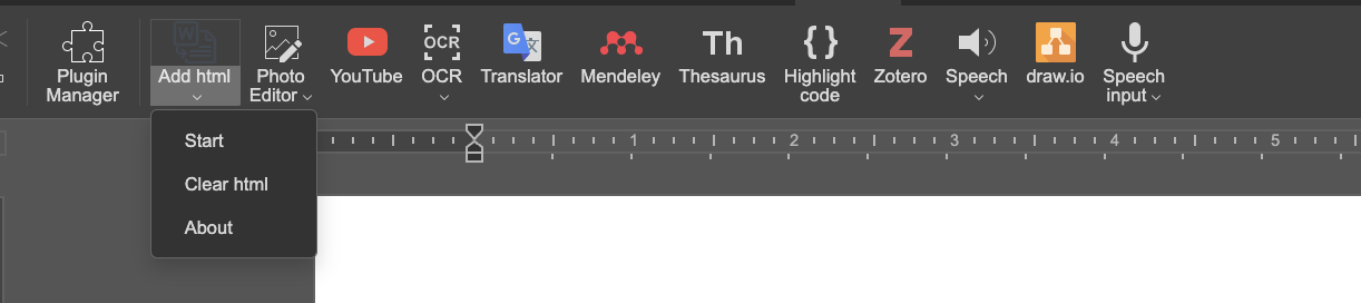

How can i trigger “Start” function automatically on document load?? and the manual button should also be available… is there way to seperate if its automatically triggered or manually triggered??

@Constantine i’ve tried the above solution but still its not working… its triggered when start button is clicked… i’ve added the event on config as well.

Can you share function that is used for Start button of your plugin for better understanding of your design?

@Constantine thank you for the quick reply. but i want to also distinguish the event if its automatically triggered or manually clicked by user…
Not quite following the concept of such decision, but considering that autostart is the only option here, you need decide how to handle plugin pre-initialization of the editor.
You need to somehow add up a criteria or check in your storage application under which editor will be launched with autostart or without it. This is purely your task, not much I can help you with from plugin perspective. Basically, buttons will be always available for your plugin, unless you make it system or hidden, but to autostart it or not can be handled only from initialization config.
