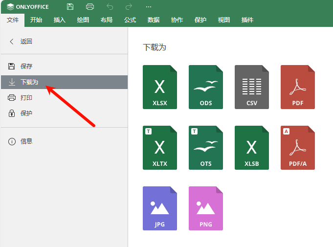

Hello,we are using the community version of OnlyOffice. Due to some issues in the production environment, when clicking the “Download” button in the toolbar, the download does not work properly and the browser reports an error:
Mixed Content: The page at 'https://my-domain.com/#/online-office/edit? uuid=21132feb-f19f-4889-86bd-5fa3810d5682' was loaded over HTTPS, but requested an insecure frame 'http://my-domain.com/onlyoffice-api/cache/files/data/DOC_xxxxx97_9499/output.docx/xxxxx.docx'. This request has been blocked; the content must be served over HTTPS.
At the same time, I found an “onDownloadAs” event in the API documentation (Events | ONLYOFFICE), but it did not work after being configured.
So, I want to know if there is any way for me to monitor the user’s “download” behavior in the editor and handle the download logic myself.

Thank you for your reply. We have resolved the issue with HTTPS.
As for downloading, I do refer to browser downloads, the “download as” function, and I want to monitor the user’s download behavior.
