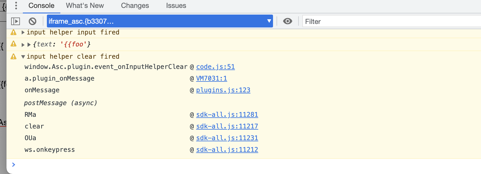

As noted in comments, I see that if the user types “{{foo.” I get an oninputhelperclear event from the “.” keypress.
If I add a debugger statement and look at the stack trace in the browser this comes from a keypress event which explicitly posts the inputhelperclear event message to the plugin frame.
Here’s a screenshot of that stack trace:

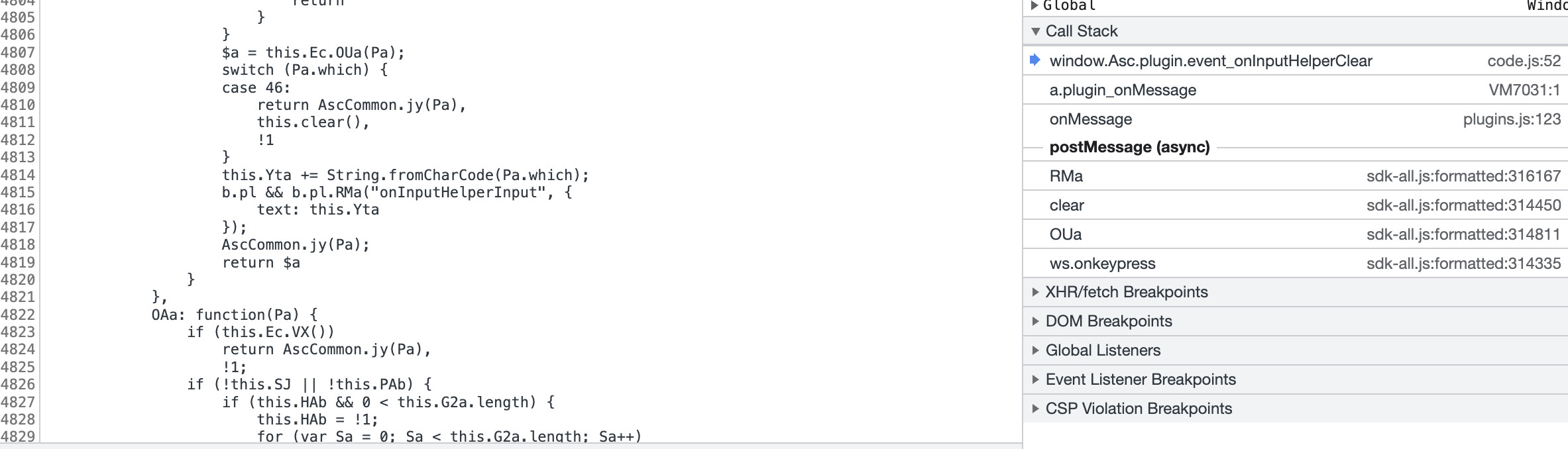

Here’s the source I see if I click on the “OUa” method:
[EDIT: See line 314811- labelled just “4811” in my screenshot - for the call to ‘clear()’]
It appears to be querying for an event character code value of 46 which is “.”: HTML Charset
I can record a video walking through this stuff if that’s helpful too, but I suspect this should give you everything you need.
As far as I can tell, dismissing the input helper on “.” keypress is a feature/default behavior and I’m basically asking if there’s any way to turn it off so I can continue to recieve the oninputhelperinput events after the “.” keypress and see the full string of text typed by the user up to the previous space
