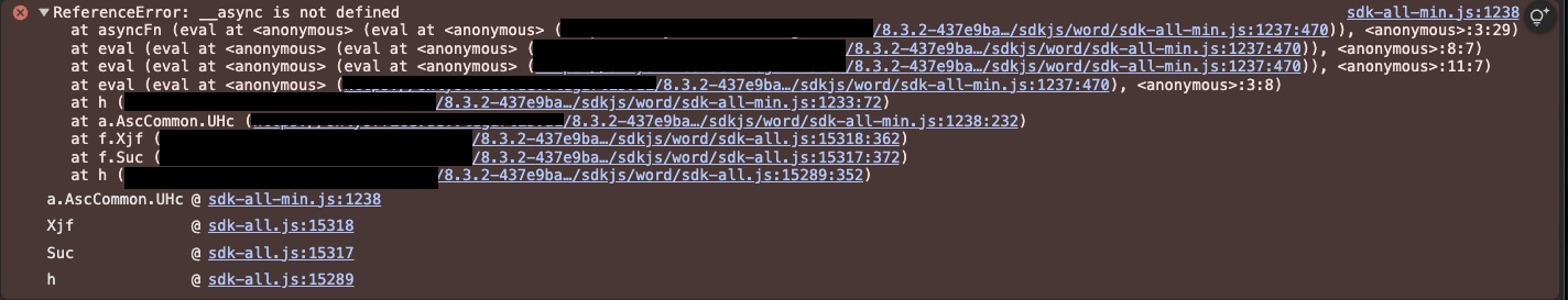

I tried exactly you function above and I am receiving the following error:
ReferenceError: __async is not defined
Has something changed with the new version? (I am running 8.3.2) Or do I need to do something different now?

Hello @dorin
The code above works as expected, nothing has changed. Can you share content of your .js file that executes it for reference?

Hi,
Sure, this is my code. The plugin is written in Angular (with Typescript) and this is running in the main component (app.component.ts).
    ((window: Window
        window.Asc.plugin.init = function init() {
          Asc.plugin.callCommand(() => {
            const asyncFn = async () => {
              const res = 3;
              console.warn('Console Log: ', res + 1 ); // Here I've added 1 to demonstrate the it returns res separately
              return res;
            asyncFn().then(res => {
              console.warn('Returned: ', res + 2) ; // Added 2 to the res to demonstrate the result being separate from previous one
          }, false, false);
        window.Asc.plugin.button = (id: string) => {}
      })(window);
