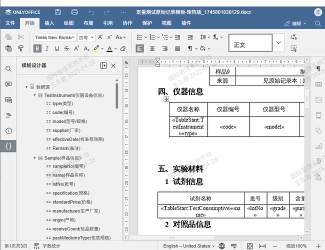

we are developong plugin to drag drop content to cursor position with code, so we need know the object under cursor,so that can refrence the object in plugin code

Please describe the entire scenario. Are you using self-written plugin (left side of your screenshot) and planning to drag’n’drop data from it to the editor? It’s not clear how you are trying to implement mail merge feature in this scenario.
What exactly is being dragged? Some sort of content controls? and what should happen after dropping? Simple text insert or do you wrap it to mail merge field?
Please show us the entire scenario step-by-step, so we could assist you promptly.

Thanks for your help. We need to know whether it is in table for the merge field “TableStart” and “TableEnd” for the following:
Hi,
is there anyway to know the para, which is created by Api.CreateParagraph(), is in table? we need to give the proper merge field “TableStart” and “TableEnd” for the field name:

I am not following your goal with the plugin. As I can see, you have a panel in your plugin with fields to insert into a document, initially you wanted to drag’n’drop them, but I do not see any reason to do that. Since the panel already contains a number of merge fields for insertion, from which you can manually select a field to insert, I do not understand why you would like to know where the cursor is instead of simply putting cursor to required position and then adding the field from the list.
Please provide more details to your designed. For now, it seems we are running in circles.
Hi,
Sorry, for the confusion, we need to define the fieldname, eg. when it in normal cusror postion, the merge field code would be: “<<Sample.sampleNo>>”, however, when it in table, we need to define teh merge field code: “<<TableStart:Sample>> <<>>” or “<<TableEnd:Sample>> <<>>”
I’m afraid there is no such method that would allow getting the object under the cursor and getting its class type. Considering this, I am suggesting to revise the logic of your plugin. You can create as many needed merge fields on your panel and add them by click to cursor position with InsertContent method only.

I doesn’t agree with you, the senario plugin is a general template designer. It’s normal mergefield or TableStart/TableEnd mergefield is decided by the target template not by the plugin.
