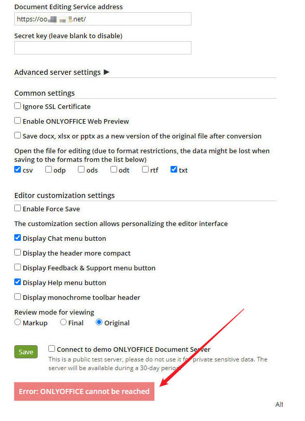

access https:// alf.mygreatdomain.net/alfresco/s/onlyoffice/onlyoffice-config,
fill the Document Editing Service address with: https://onlyoffice.mygreatdomain.net/
then hit Save, occurs “Error: ONLYOFFICE can not be reached”.

Also please go to connector page >click Save button > show us the error message (make screenshot).

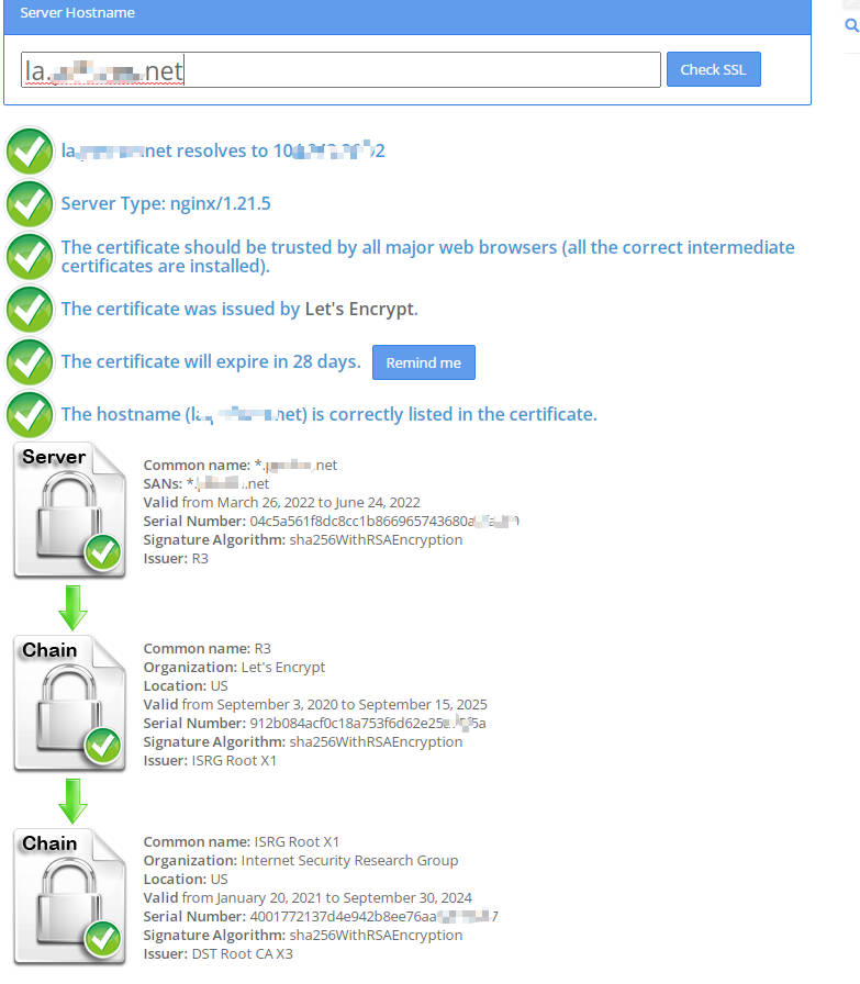

Hello, @Alexandre Thanks for guiding.
SSL Checker all green.
