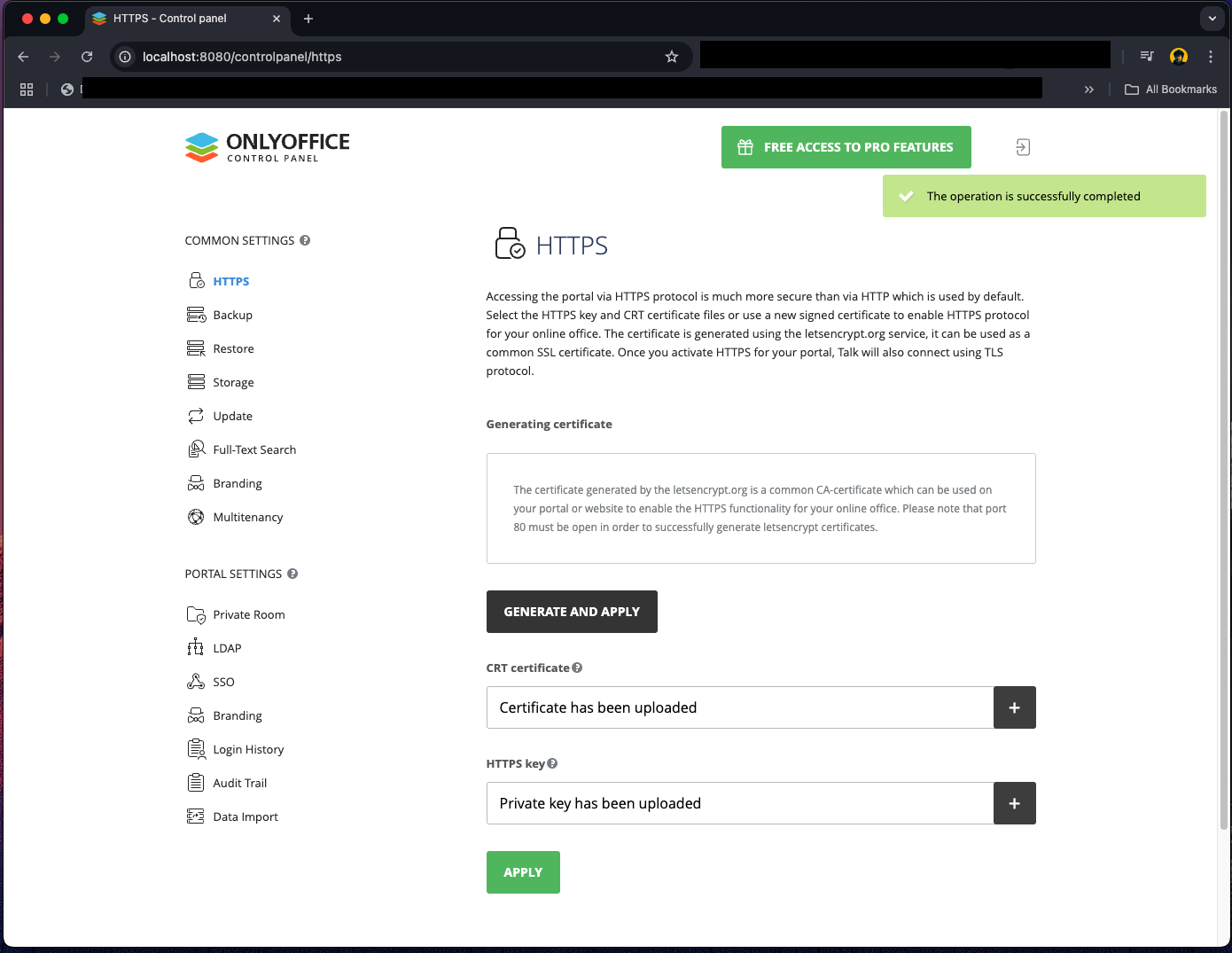

The guide is incomplete; the Control Panel operation completed successfully, but accessing the Workspace via HTTPS still results in a connection refused error.
The issue is that OnlyOffice Workspace does not display the domain name in the box after the “successful operation” message.
I have reviewed several video guides and the documentation, and I believe it should show the domain name in the central box.
What could be missing?
(I’m accessing the Onlyoffice deployment through SSH port forwarding for security instead of accessing it through the public domain which is only HTTP)
Sorry for the delayed response. It can be seen that you are authorized using localhost. Please authorize using the domain name and try obtaining the certificate again afterward
