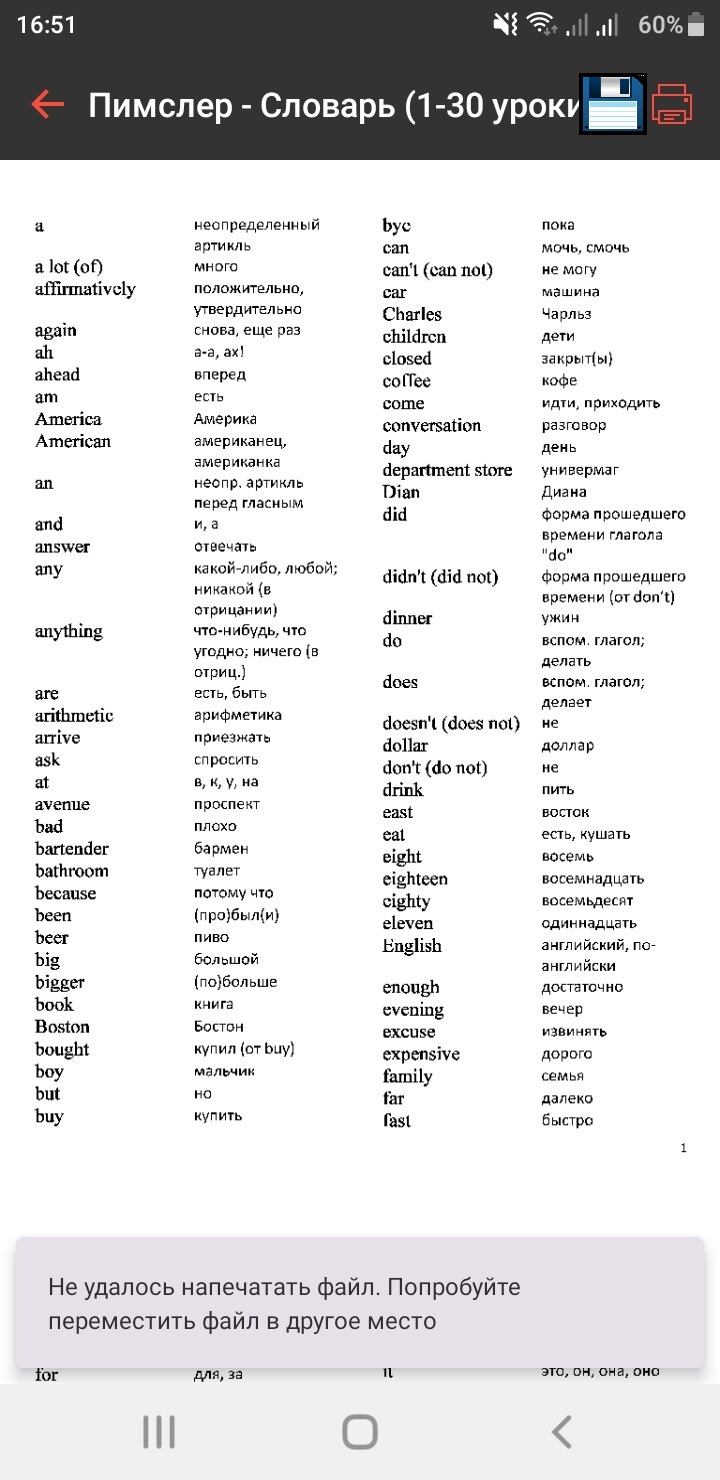

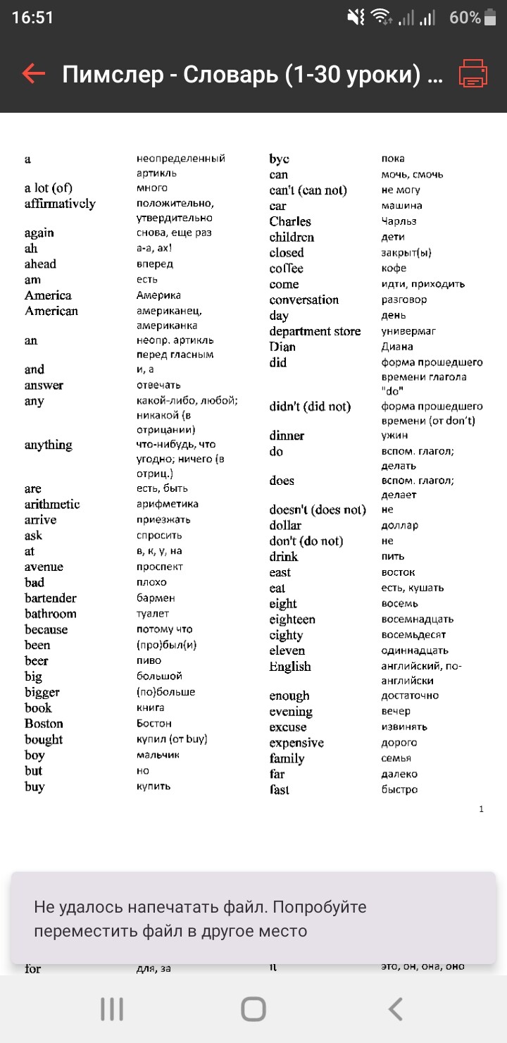

I am attaching a screenshot.
It shows what happens when I press the print button. It also shows that a dark theme is selected, but the background is white. Regarding the third point, it is not possible to show it in the photo. I tried other applications and there was the ability to highlight text. I chose your product because it is very compatible with Microsoft Office Documents.

You understood correctly. My smartphone is rooted and I deleted this application.

I see a separate button here. That is, one button is for printing and the other is for saving.
I specifically removed the print spooler because I don’t need this feature and it uses a lot of RAM in the background. I only have 1 GB of RAM.
So I don’t want to restore the system to its original state.
Can you please provide a screenshot of this button for reference?
I understand the situation as following: in your app downloading/saving files is blocked and you are viewing PDFs in ONLYOFFICE Documents but without print spooler it is not possible to save the file to local storage according to your description, is that correct?
If that so, then I’m interested in how exactly you are opening PDFs from your app in ONLYOFFICE Documents? Can you make a video demonstration of this scenario for better understanding?
It is clear that PDF is already downloaded to file manager in this case and simply opened via ONLYOFFICE Documents.
For this case, it is important to know that for PDF viewing we are using third-party app, e.g. system build-in viewer, e.g. the one on your screenshot. So considering this, I’m afraid we cannot add custom buttons to it or change its properties and it also explains why you cannot use Print button without printing spooler to save file locally as per your workaround.
