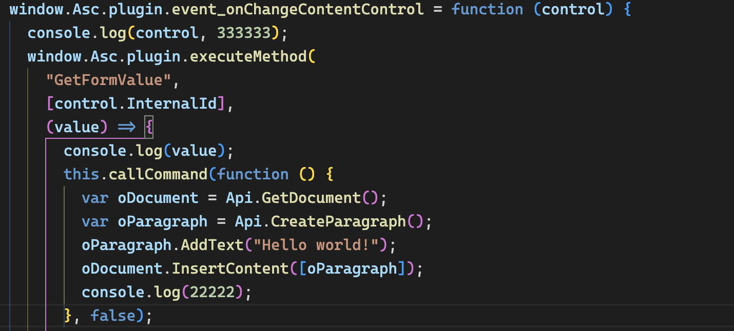

hello, If the event_onChangeContentControl event is triggered by a form change, the contents of the callCommand are not executed
onBlurContentControl is ok
Hello again @GGbeng
We will take a closer look at the situation and I will inform you about the results.
