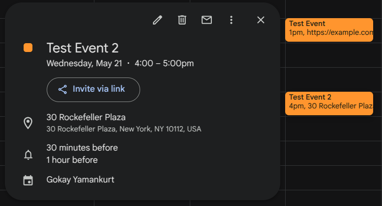

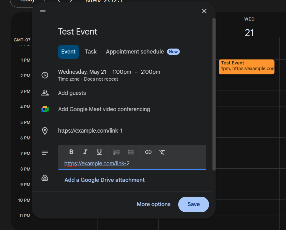

I manually inserted links similar to you in a simplified calendar and found that the Location field is not synced from Google at all. Here is the Google Calendar event I am creating:

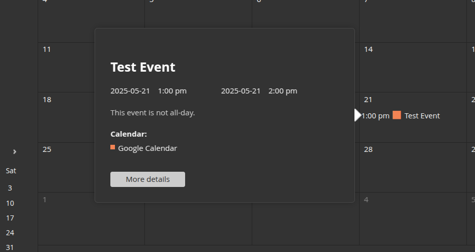

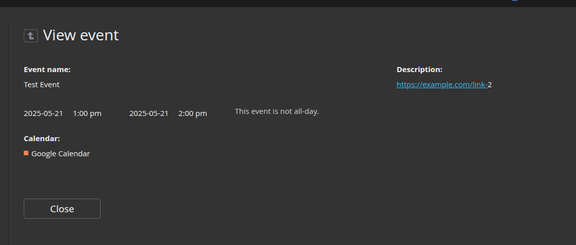

I added 2 different links to the Location and Description fields so that I can tell which one is coming into OnlyOffice. Here is what I see in OnlyOffice:
The Location link is not there, but the Description link does sync like you observed.

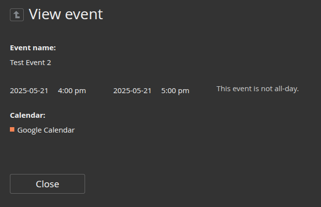

Furthermore, the issue is not limited to links. I tried it with a physical address and observed the same issue:
Address 2
As you can see, physical addresses are not synced to the Location field of the OnlyOffice event.
I hope that clarifies it. Thanks again for looking into the issue.
Thank you for the reply. Indeed, I can see that the location field is not synced. This behavior is a bug. We are working on it, but I cannot provide any ETA at the moment. As a workaround, you can mirror the same information about location in description field that is synced.
