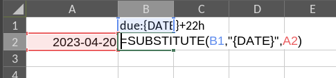

I’m trying to use the substitute function to format a date into a string.
On the left is the date, on top is the initial string, and on the bottom is the final string.
Screenshot_20230420_121559
The final string formula: =SUBSTITUTE(B1,"{DATE}",A2)
I want the final string to look like due:2023-04-20+22h, but the SUBSTITUTE function is not outputting 2023-04-20, instead it’s outputting 45036. I suppose this is the number of days since epoch 1900-01-01.
How do I get the date to format properly within this substitute?
Figured it out. Can use TEXT(A2,"yyyy-mm-dd") format it correctly.
