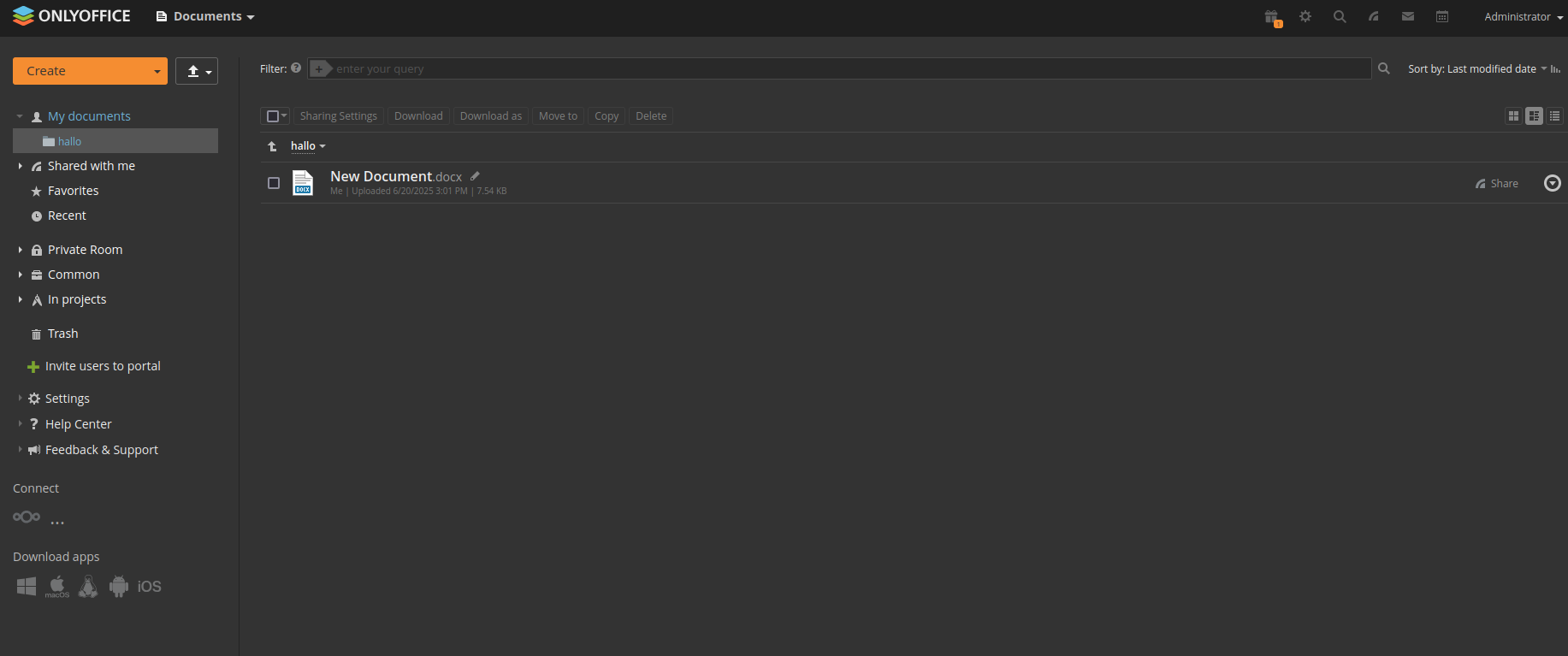

It successfully execute the script but creates a document called : New Document.docx
Why is that? and how can i fix that so that it will upload the correct file?
