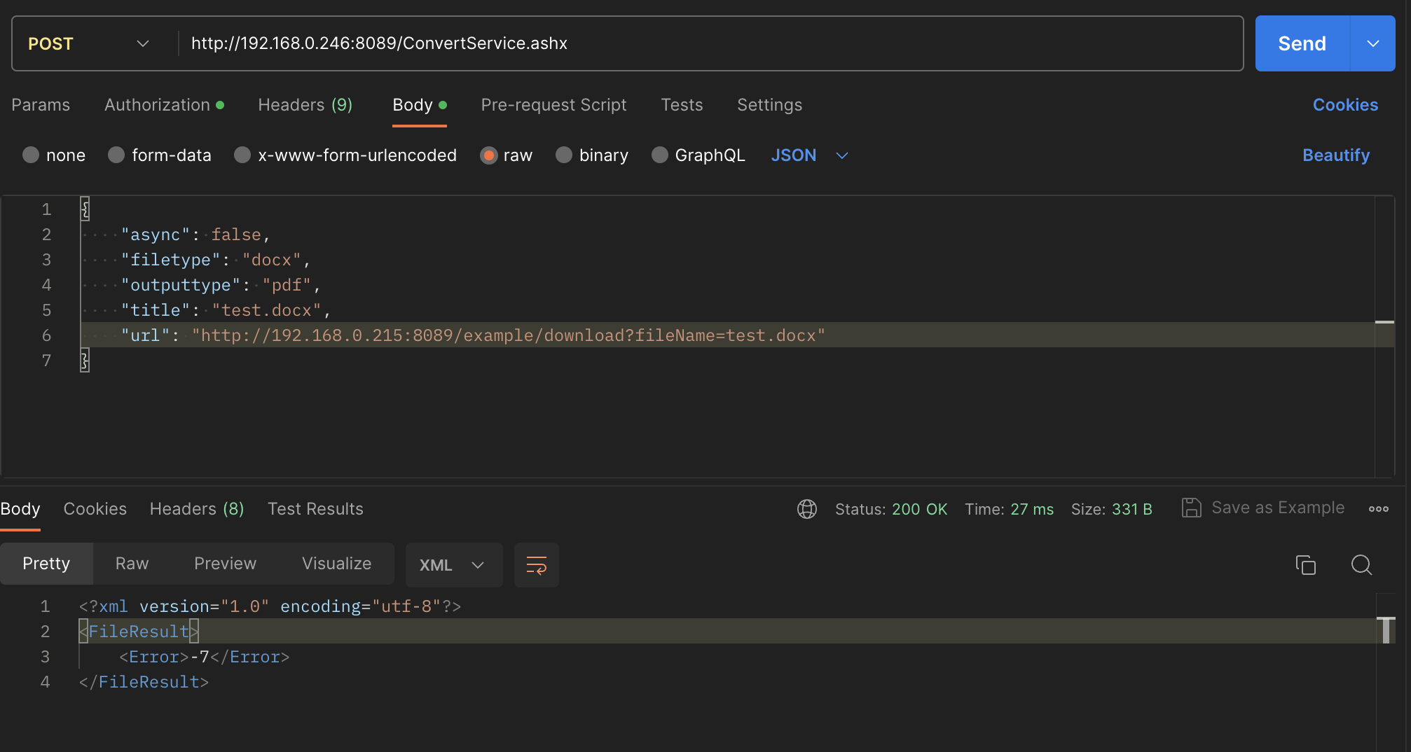

When I submit a request according to the documentation, I get an error -7. It is not clear from the logs what the problem is. When I look at the logs, the problem is in the outputtype, but I seem to be entering it correctly. Please help me figure out what the problem is.

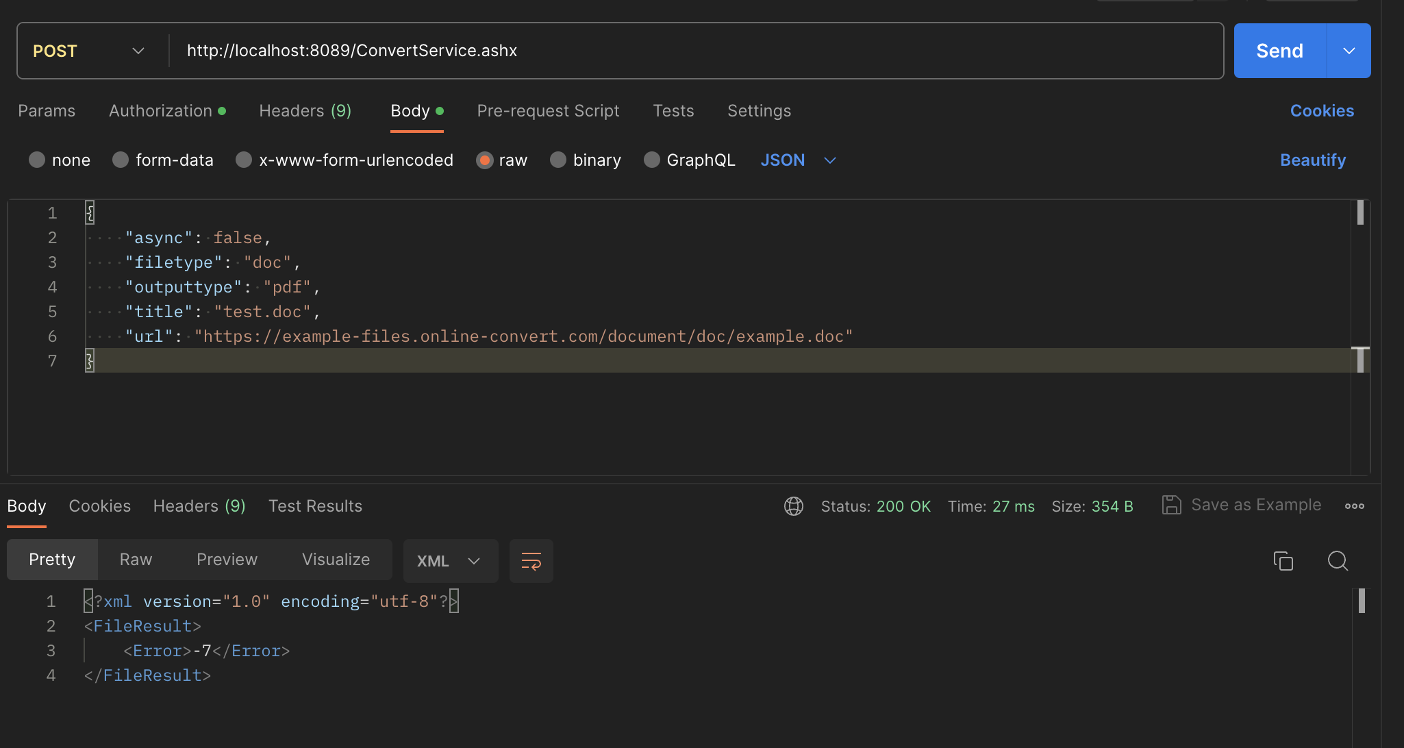

Thank you for your answer. But, I have tried other links as well. For example: minio server (bucket is public)
Did the error stay the same?
-7 Input error
Yes, I tried in different ways

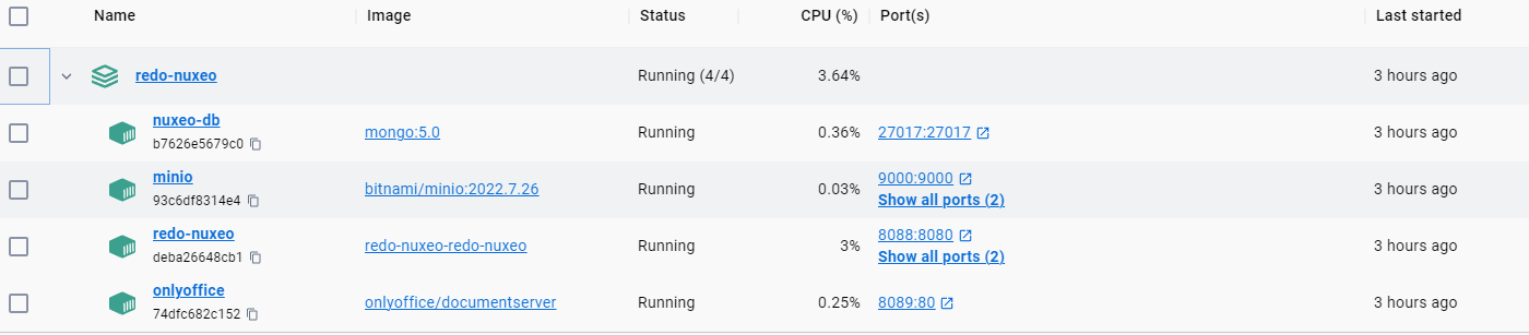

Please specify according to which instructions you installed the document server and the version of document server.
The problem repeated on all files. I run onlyoffice using Docker.
I was able to reproduce this error.
The problem is in the correctness of sending the request.
-7 Input error
(Most likely one of the letters in the request was written in another language) Because the entire request is written correctly.
Try typing add the following request body:
"async": false,
"filetype": "docx",
"outputtype": "pdf",
"title": "test.doc",
"url": "https://example-files.online-convert.com/document/doc/example.doc"

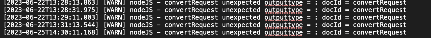

Hi @zvuk331, please attach Document Server logs from /var/log/onlyoffice/documentserver/
after reproducing the issue.
Hi @Carl
Only this in the logs
Text: [2023-06-25T14:30:11.168] [WARN] nodeJS - convertRequest unexpected outputtype = : docId = convertRequest

I was able to reproduce this error when the “outputtype” field is incorrect. Like this:

and log is:
[2023-07-24T07:25:05.776] [WARN] [localhost] [conv_undefined_] [userId] nodeJS - convertRequest unexpected outputtype =
[2023-07-24T07:25:50.553] [WARN] [localhost] [conv_undefined_] [userId] nodeJS - convertRequest unexpected outputtype =
[2023-07-24T07:25:54.282] [WARN] [localhost] [conv_undefined_] [userId] nodeJS - convertRequest unexpected outputtype =

How did you install the document server?
Let me try to install according to your scenario.

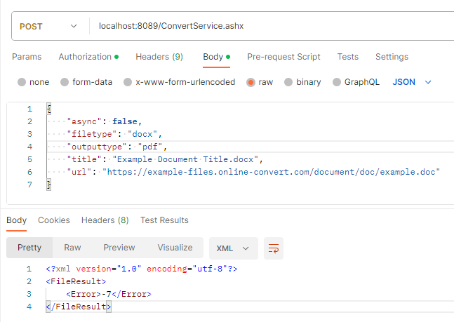

Hello
I am running document server in docker
and i can reach it from url localhost:8089
but i can’t use Conversation API correctly
in documentation says:
Sample of JSON object sent to document conversion service used to convert the file from docx format to pdf format
"async": false,
"filetype": "docx",
"key": "Khirz6zTPdfd7",
"title": "Example Document Title.docx",
"url": "https://example.com/url-to-example-document.docx"
