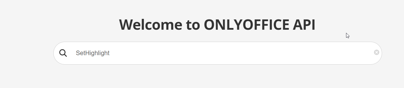

For more detailed documentation on methods, visit https://api.onlyoffice.com/docbuilder/basic.
You can easily search for the method you’re interested in.
Additionally, you can find the structure description for each editor:
