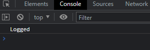

Here is a simple example of how this new method can be used (script.js file):
(function (window, undefined) {
  window.Asc.plugin.init = function () {
    Asc.plugin.attachEditorEvent("onDocumentContentReady", () => {
      console.log("Logged");
})(window, undefined);
To make this sample work I am specifying "isSystem": true in the config.json file of a plugin to make plugin start upon editor initialization.
Note: in the same config.json I am not specifying onDocumentContentReady event in the events array (as it is with regular approach with attachEvent method).
As a result, I can see that plugin works as it prompts “Logged” into the browser console once document is ready to be edited:
I hope it helps.
