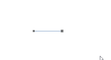

So, it would be great to add a shortcut (for instance, CTRL + drag) to constrain the change of angle of the line/arrow to 15-degree interval, like this :
soffice.bin_qUAYbD8qaE

The screen cap in my initial post it taken in LO, in the presentation app. There is an 18° (not 15) interval, and that’s handy.

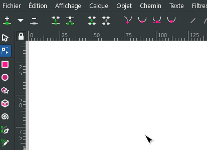

In Inkscape, the interval is off by default (beginning of the bellow screencap), and if you press shift, it’s activated:
inkscape_RJThteKloh
That’s what I have in mind.
