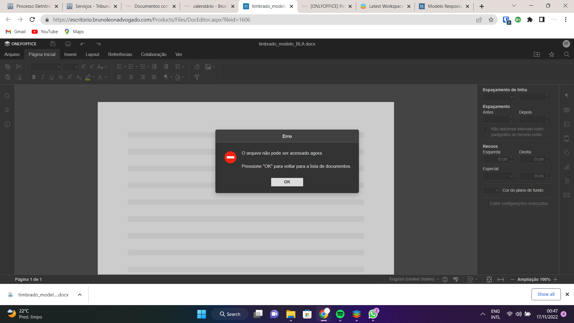

Error: The file cannot be accessed right now. Press "OK" to return to documents list
Out of the blue I have started getting this error. My system is in Portuguese (Brazil), but it shoud translate as something like this: Error: The file cannot be accessed right now. Press “OK” to return to documents list."
It does happen when I try to open any document from the server (OnlyOffice WS Community Server, running under Ubuntu Server 22.04).
Thanks in advance guys :wink:

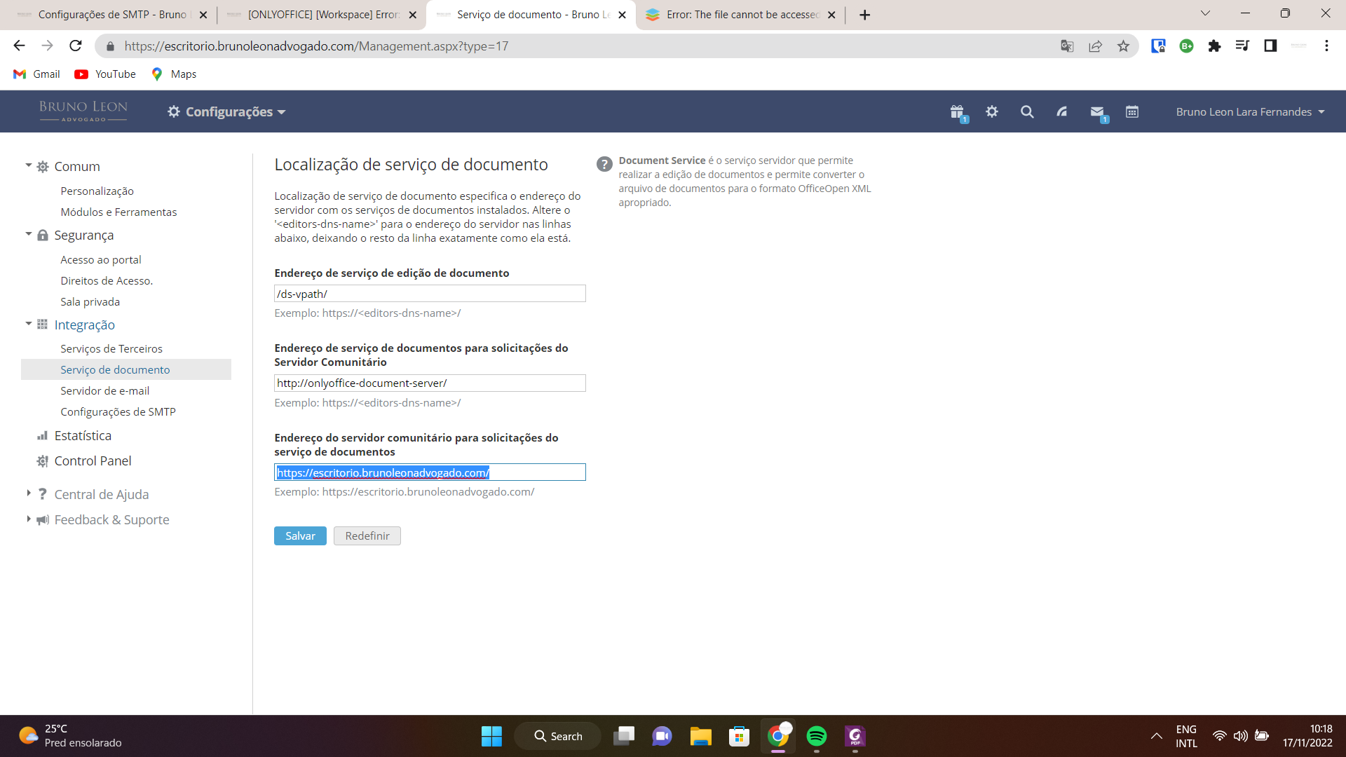

Hi again Constantine, I did actually find the issue, it was this entry:
After using the correct domain, it now works.
Thank you anyway :slight_smile:
