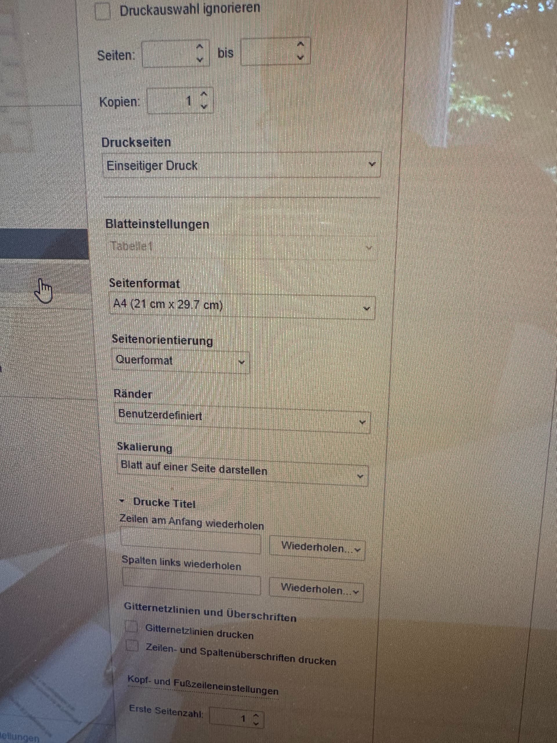

OnlyOffice also shows A4 in the Print settings:
[can only add one picture :-(]

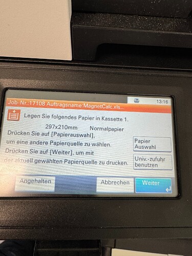

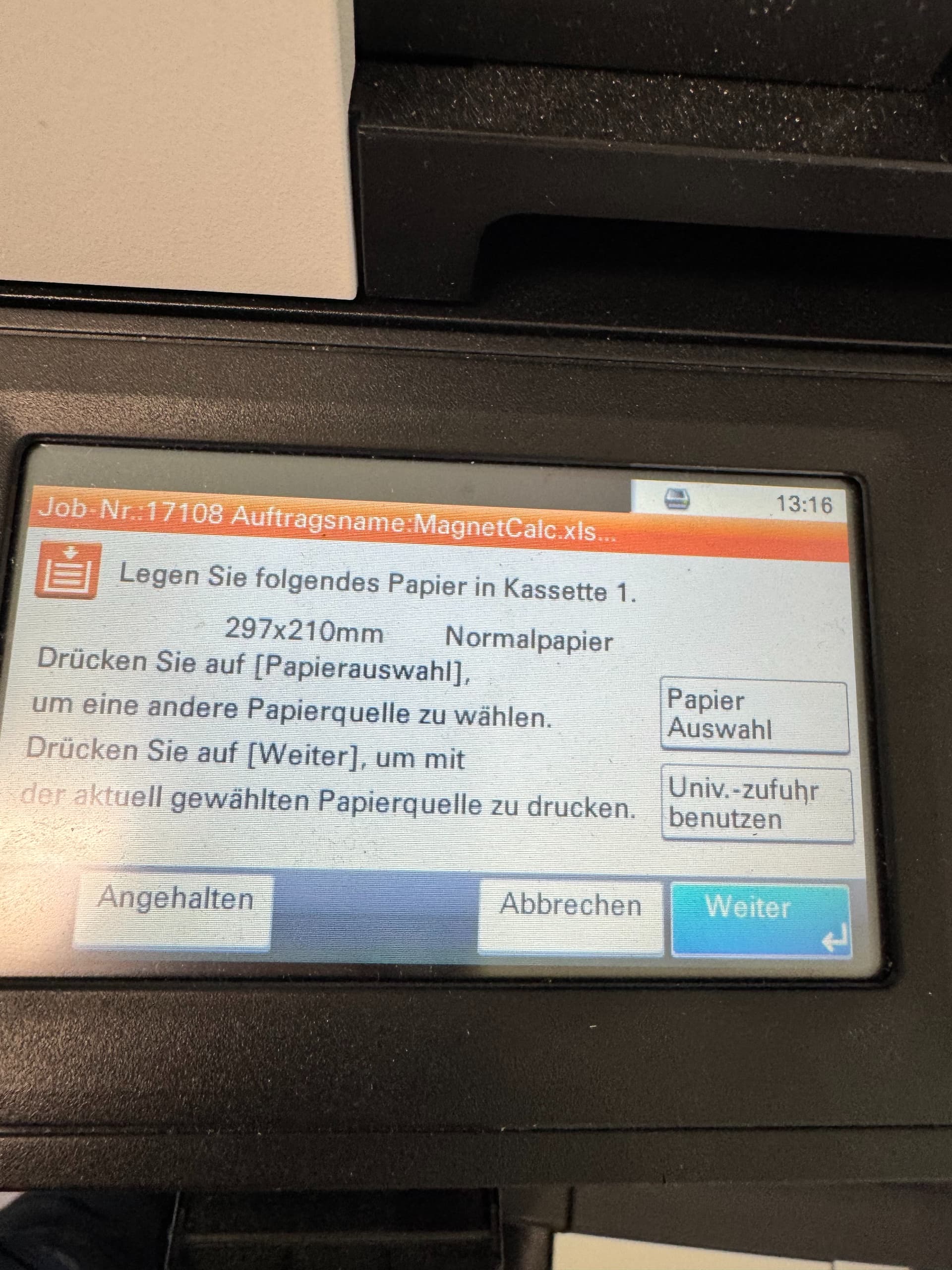

Yet the printer complains that 297x210 should be added to cassette 1 (which contains A4 paper):
As suggested above I believe this is because the printer expects the paper size to be A4 but 210x297 is sent (which is obviously the same in dimensions, but probably a different naming).

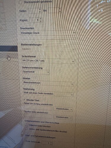

This is the printer setting in OnlyOffice print dialog:
As you can see "Seitenformat (page format) is set to A4 and orientation to “Querformat” (landscape). It doesn’t matter if it’s set to landscape or portrait, the result is always the same.

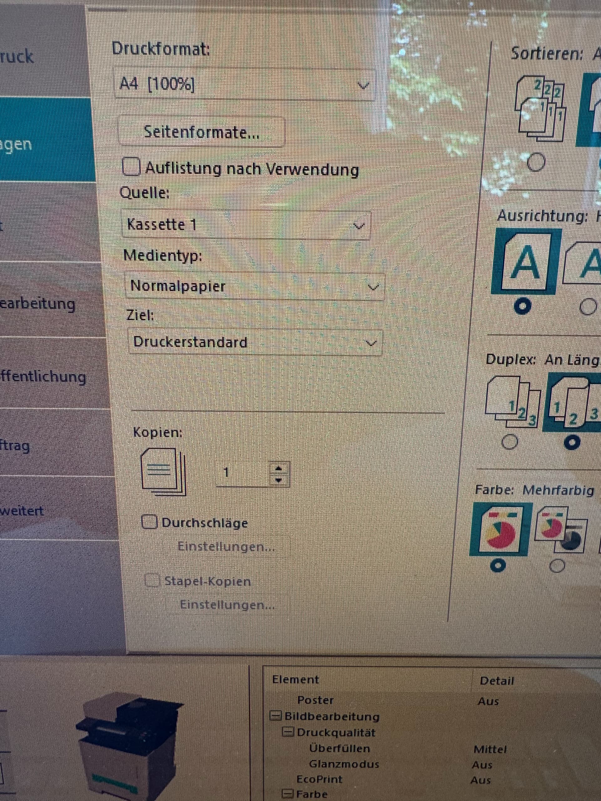

These are the printer settings in the printer driver:
Pagesize here is set to A4 and in fact you can only select defined formats (like A5, A4), not something like 21x29.7cm. Paper type is “Normalpapier”, which is what you can also see in the picture from the printer display.
However the printer requests 297x210 paper. As I already said: orientation doesn’t matter, the message is always the same. The paper tray is set to A4 in the web interface of the printer and that works perfectly fine with the same printer driver on the same machine for Excel or Adobe Acrobat. I get a similar message on the printer display when I set the paper size to A5 in the print dialog of Acrobat (“Legen Sie folgendes Papier in Kassette 1. A5 Normalpapier …”).
Summing up: It seem that when printing to A4 instead of A4 the dimensions of the paper are sent to the printer and this is specific to OnlyOffice, other applications work in the same setup.
