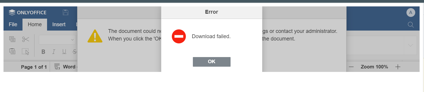

I installed the onlyoffice/documentserver on a linux 20.04 LTS server to have access to the api.
Now I’m trying to open it in my laravel project but I get errors that I can’t fix.
Thanks in advance for your help.

Hello @Ornice
I believe we have to check out Document server logs first. They’re located here:
docker: /app/onlyoffice/DocumentServer/logs/documentserver/
deb\rpm: /var/log/onlyoffice/documentserver/
By the way, please point me to the guide which you used for Document server installation and version of the installed app.
About Laravel in general. We don’t have ready-to-go integration examples for Laravel, but as far as I understand, the Laravel is PHP-based solution, so our PHP example (ONLYOFFICE Api Documentation - Example) probably will be useful in your research.
Thanks Alexandre.
For the guide, I used the linux installation guide available at onlyoffice/documentserver.
I used the following Basic example:
https://api.onlyoffice.com/editors/basic
Yes, Laravel is based on php, which is why I was able to try the basic formula to begin with.
I also have an instance on Angular that returns the same errors
I already have my onlyoffice/documentserver deployed on a linux remote server so I use the
https://xxxxxxxxxx/web-apps/apps/api/documents/api.js for integration. I don’t want it local by the way.
Sincerely
Hello @Ornice
I’d like to join this thread.
Main reasons of these issues are desribed here:
https://api.onlyoffice.com/editors/troubleshooting#download
https://api.onlyoffice.com/editors/troubleshooting#error0
For further assistance, we surely have to take a look at the logs of Document Server as my colleague suggests:
I might misunderstand but if you are using this address for integration in your apps as Document Server address, then this is wrong. Proper address is just https://<documennt_server_address/
without any additional info.
Glad to hear that it is solved now!
