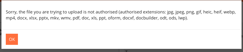

I created a simple Flat odt (*.fodt) with no spaces between paragraphs to assist you in the troubleshooting process. fodt’s are a lot easier to read that odt’s as they are not compressed.
Would you add *.fodt to your allow list?

Thank you @Todd :slight_smile:
At the moment, the option ‘Don’t add interval between paragraphs of the same style’ is not available when converting a file to .odt. We have submitted a request for its implementation.
We’ll think about it!
