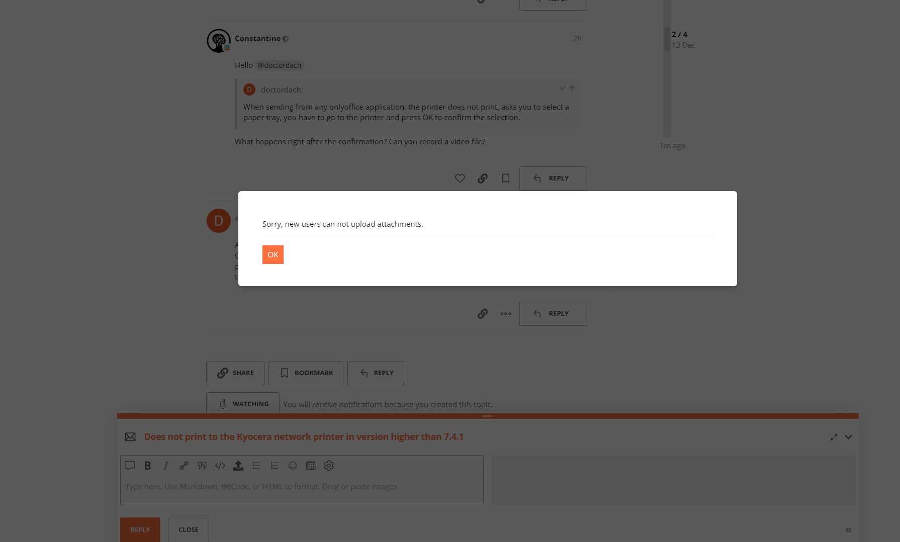

I can’t upload a video
You can upload it to any cloud storage and share a link.

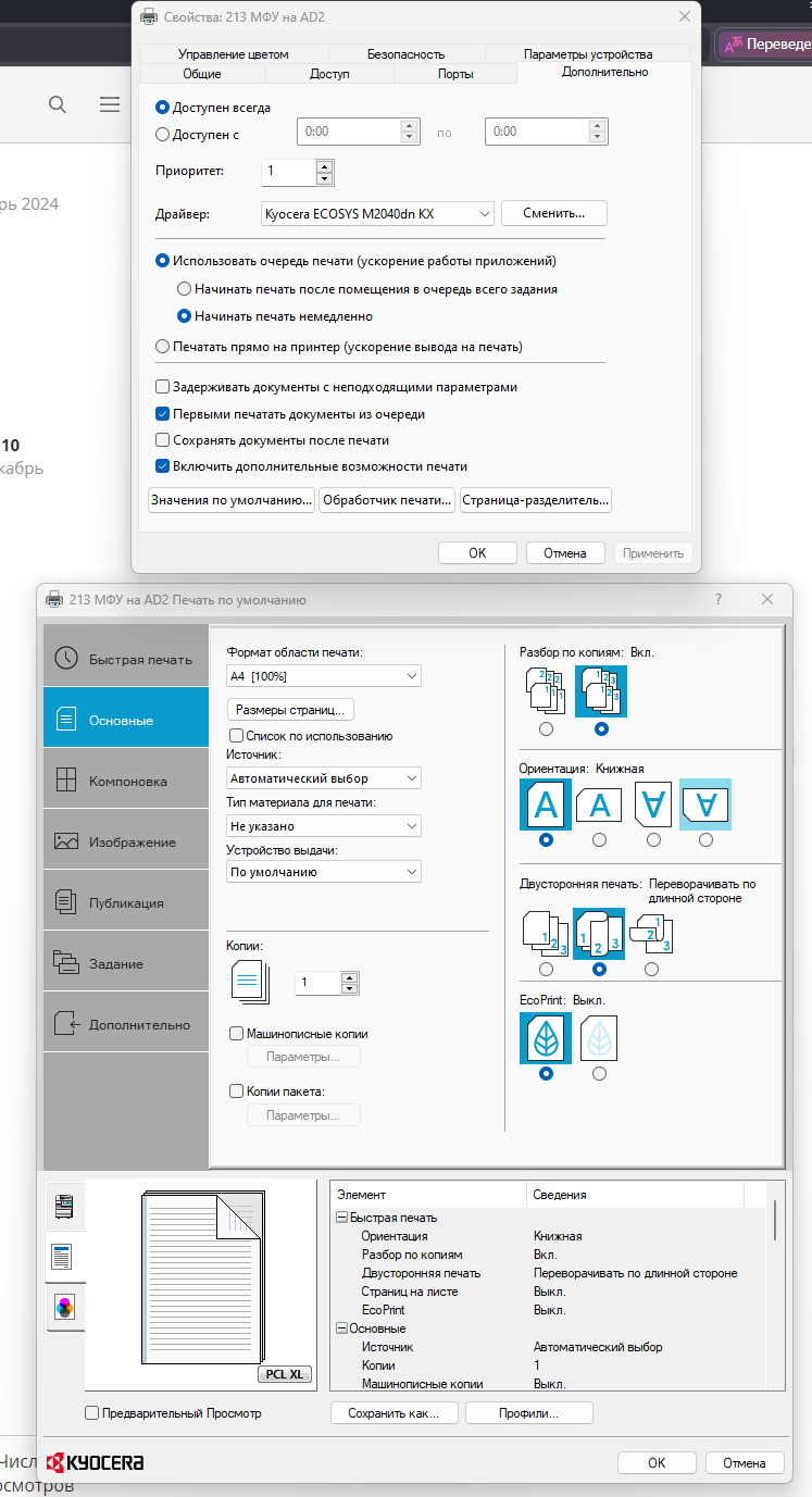

Can you please share some additional system settings of the printer? Interested to see Printing defaults and Advanced settings, which you can find by:
  • Open Start > Settings > Printers & Scanners.
  • Click your printer, then click Manage.
  • Click Printer properties.
  • Go to the Advanced tab (make screenshot).
  • Click Printing Defaults (make screenshots of Layout and Paper/Quality tabs).

  • screenshot of Tray Selection tab of the system printing dialog (after clicking print in the editor), can be found in Preferences > Printing Preferences.
The printer was added to the computer using Active Directory group policies for user groups, and the printer is deployed on the Active Directory print server.

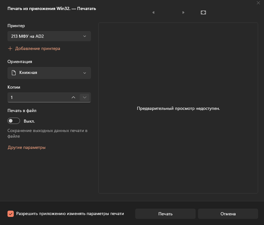

Maybe this will help: in 7.4.1, it uses the Win11 Printing from Win32 application printing dialog box
and newer versions use the standard print window where this situation occurs

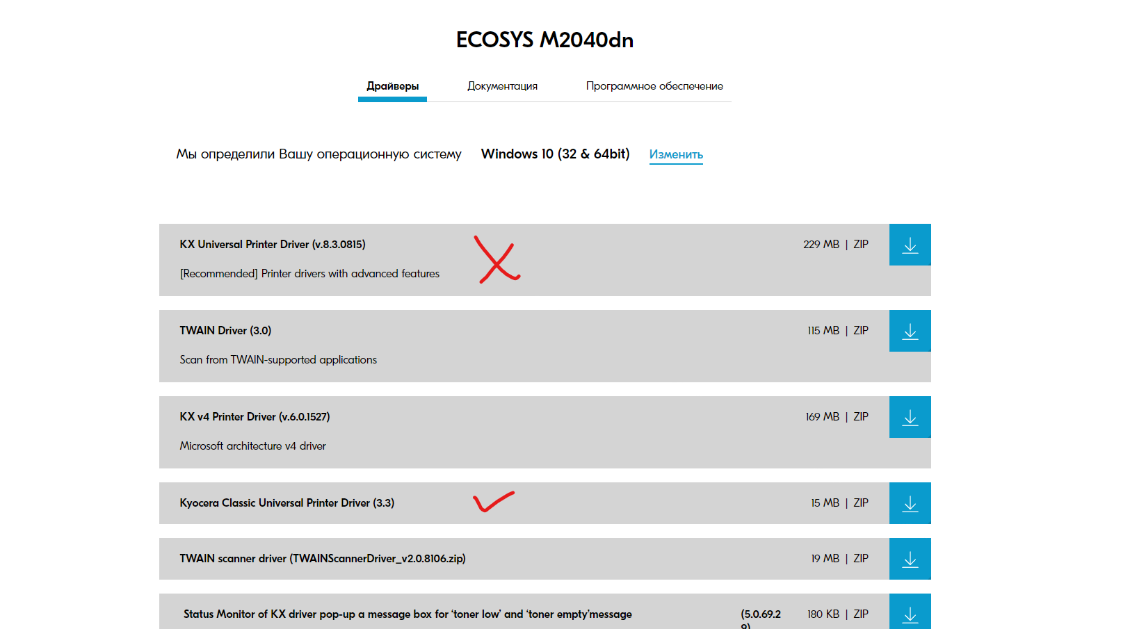

Through trial and error, it was found out that the program version higher than 7.4.1 is not compatible with the drivers for the Kyocera M2040dn/M2135dn MFPs and others using the KX Universal Printer Driver (v.8.3.0815) and lower versions of the KX Universal Printer Driver, when configuring the MFP as an IP or WSD network device.
It starts printing when using the Kyocera Classic Universal Printer Driver (3.3) (A4), but it is very inconvenient to use it in centralized management, and it loses a lot in terms of functionality.
Will it be possible to modify the program for compatibility with the KX Universal Printer Driver (v.8.3.0815) ???
