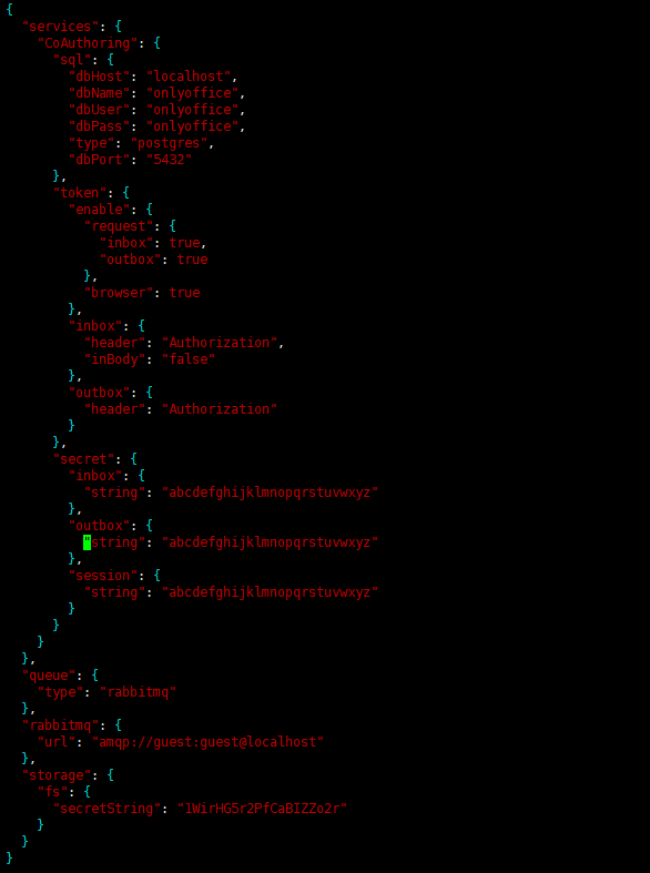

local.json :
my private process secrity key :

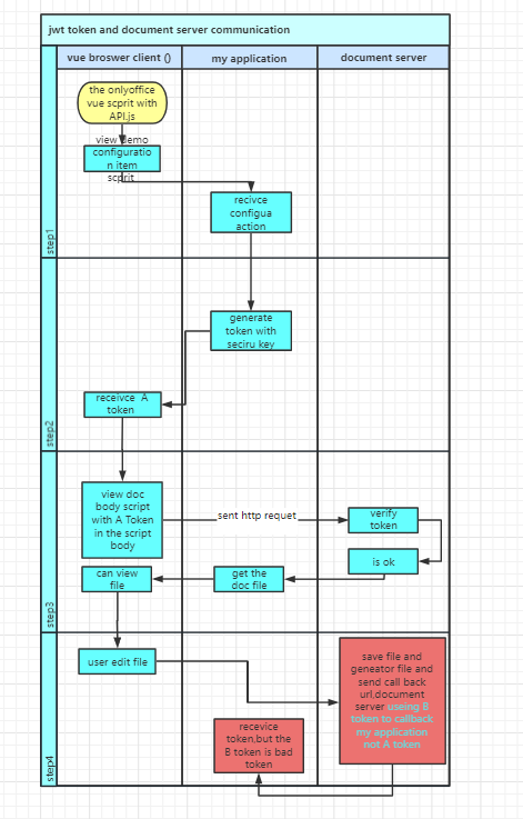

this is all the communication img between my application and the document server:
the problem :sweat_smile:
1:generator token of jwt web type is A and the document server can verify this token,the server has to local my file by the configuration item.
2.when i edit this doc ,the document server will be communication my app ,use config callback url ,but my app recive B token ,not A token,so my app to verify this token ,this token is bad token @Carl that all.
I still don’t quite understand the issue as you are talking about different tokens.
You sign the document editor initialization config with a token:
https://api.onlyoffice.com/editors/signature/browser#open
The document server signs its replies to the callback handler with a token:
https://api.onlyoffice.com/editors/signature/request#outgoing
Of course these tokens will be different as they have a different payload.
