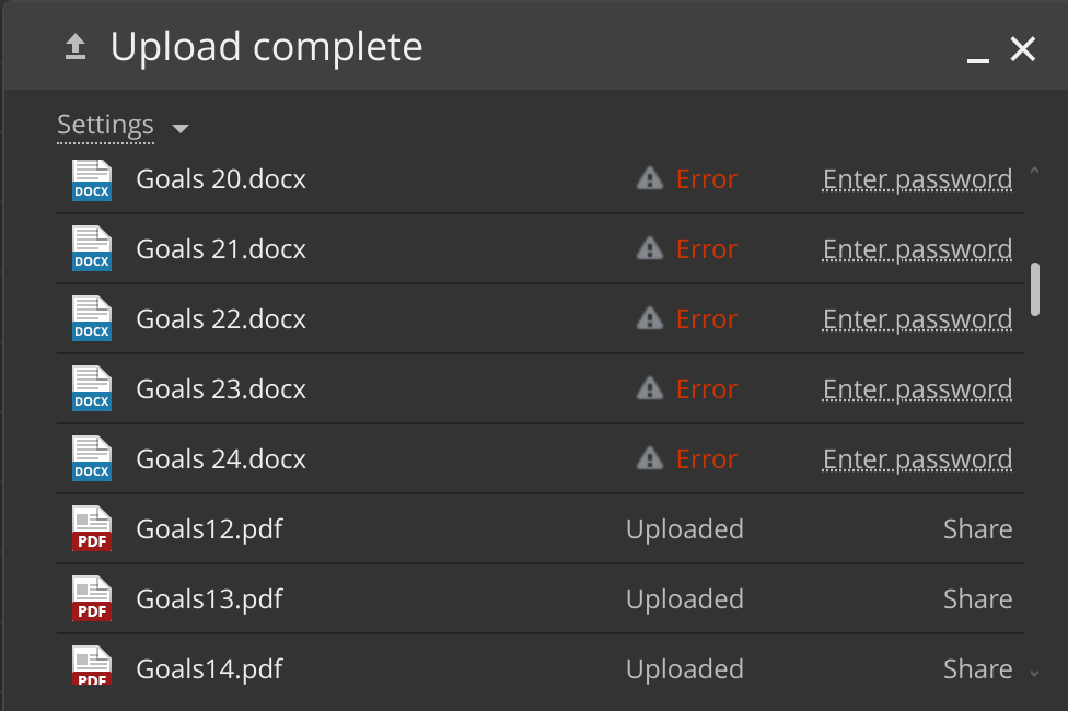

I uploaded a google docs folder from rclone 1.63.1 from documentserver 8.2.1.1, Linux Mint Cinnamon 21.1
Just about all docx documents that were from 1989 to 2010 uploaded and converted fine. All pdfs uploaded fine. Those docs from 2017 to 2024 failed with ‘You cannot upload a folder or empty file’.
If I upload individually the files that failed, they upload fine, even when showing a size of zero.

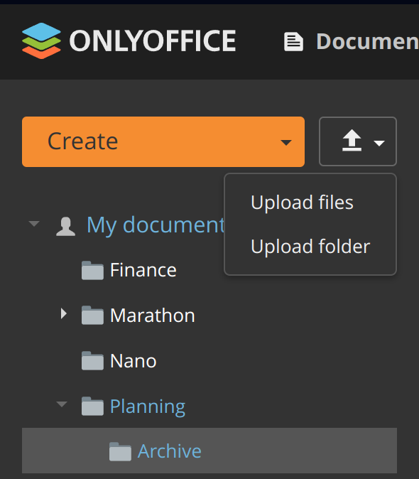

For the uploads I’m using the gui Documents, up arrow icon, Upload folder.
The Word docs get uploaded fine but on onlyoffice first access they get the “Convert and open document” dialog box which is not an issue.
Except for setting up the rclone based service on my linux mint PC, it is just point and click using the onlyoffice gui at a google Docs folder with google docs, old microsoft word docs, and pdf files.

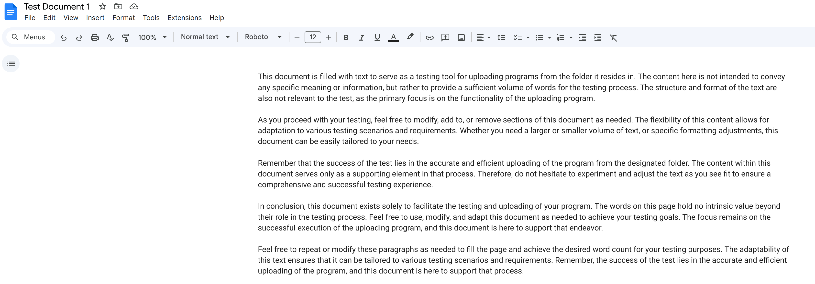

Google drive: created a folder called testupload. Created ‘Test Document 1’ filling it with content using their AI. Still in Google drive, did ‘Make a copy’ four times to have a total of five documents. I now have a Google drive folder with five documents. Went to Onlyoffice Documents. Selected the up arrow icon after the large button ‘Create’ and then selected ‘Upload folder’. Navigated to my ‘gdrive’ which is created by rclone and selected ‘testupload’. Got five ‘You cannot upload a folder or an empty file’.
I tried to upload just one file from the test folder, and got the same message, it failed. If I go back to google drive and upload a single .docx file from the last century (created in the 1990s), onlyoffice uploads the single file just fine.
I’m using brave browser but chrome had the same issue when I tried with it. Contents are nothing special, just a new file created with the current browser based google docs.
If you can create a google folder with five google docs with random text and the folder upload works for you, then its something with my setup (rclone?). The fact that it sometimes works, mostly with older file creation dates of google docs, indicates to me that onlyoffice is capable but for some reason can’t do it with the current google docs.
  1. Create google doc, random words from the ai
  2. Create five copies of the google doc
  3. Upload from the testupload folder with the five google docs
  4. Results of the upload, errors and nothing uploaded

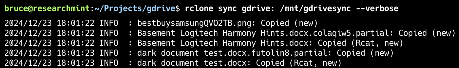

Hey @Ecurb :santa:
It seems the problem lies with rclone mount. Our team tested this scenario and found that new files from Google Drive can appear with a size of zero when mounted via rclone. This leads to errors when uploading to our platform.
As noted in the rclone documentation and in a related discussion on the rclone forum, using rclone sync resolves this issue by correctly downloading all files locally, which can then be uploaded successfully.
For now, we recommend using rclone sync more frequently as a workaround.
rclone sync works to overcome the size issue for google docs and I guess it is a reasonable way to do it if onlyoffice can’t do something to goose rclone goodgle drive into presenting the full file (in your referenced rclone forum, someone was doing a ‘cat’ on the the file contents before invoking an editor and that worked).

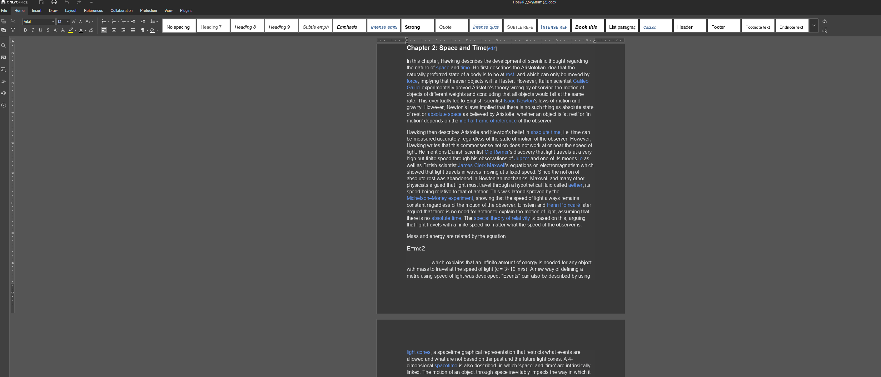

With that said, when I uploaded the google drive test folder from the rclone sync folder, the ‘Dark Document’ was again not working, but now just barely visible instead of invisible, and the styles were missing (for example: normal is missing, but right click Formatting as Style, Update Normal Style, shows it is using the normal style).
rclone sync command:
Dark Document, barely readable (previously reported with slight improvement)
Document types are still missing (previously reported)
My solution at this point in time is to cut and paste from the uploaded but damaged document into a new onlyoffice document and that seems the cleanest approach, has the fewest fix ups that need doing.

  2. Even using sync, dark document is still unreadable (now extremely dim)
  3. Imported google docs have styles missing such as the ‘Normal’ style
