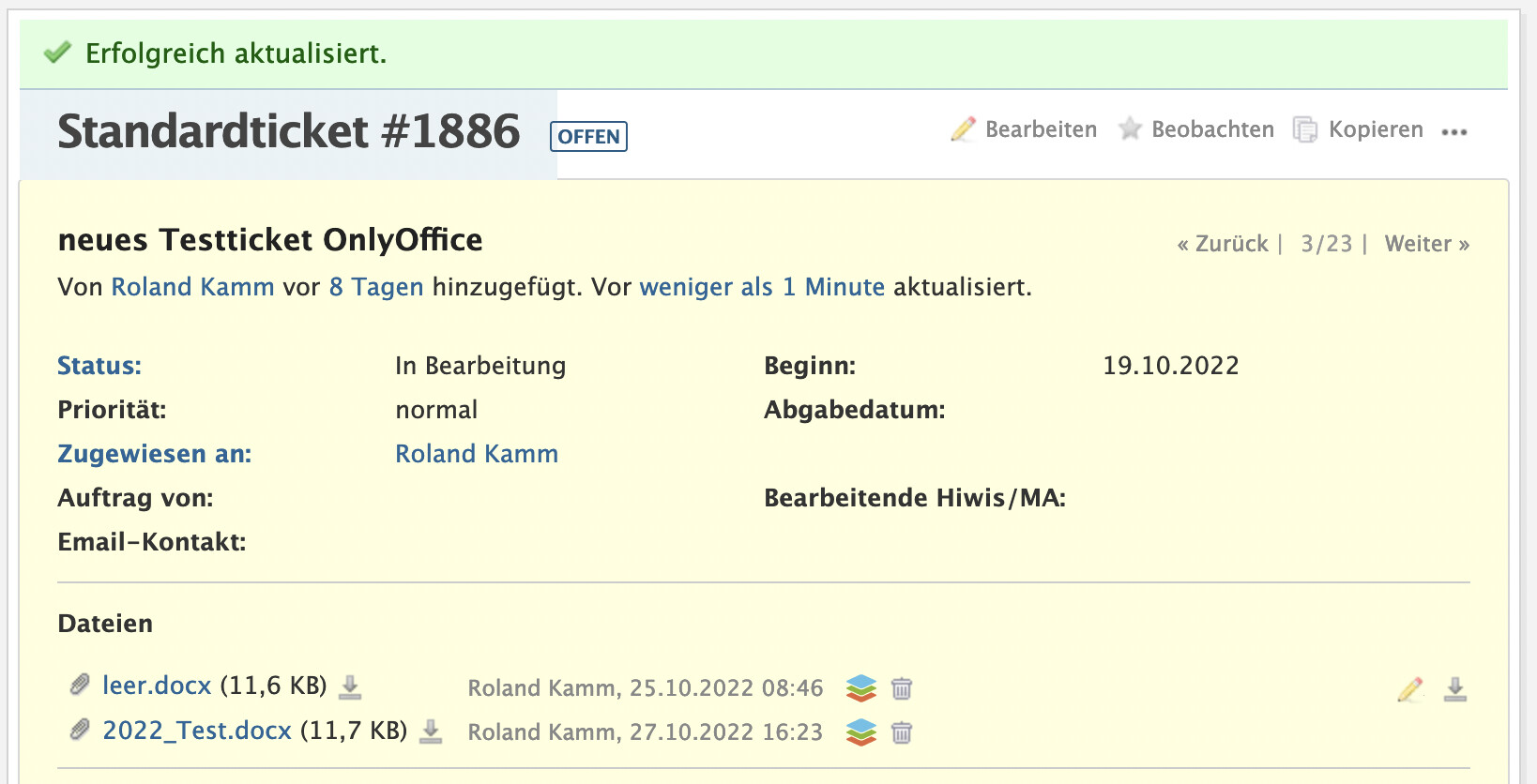

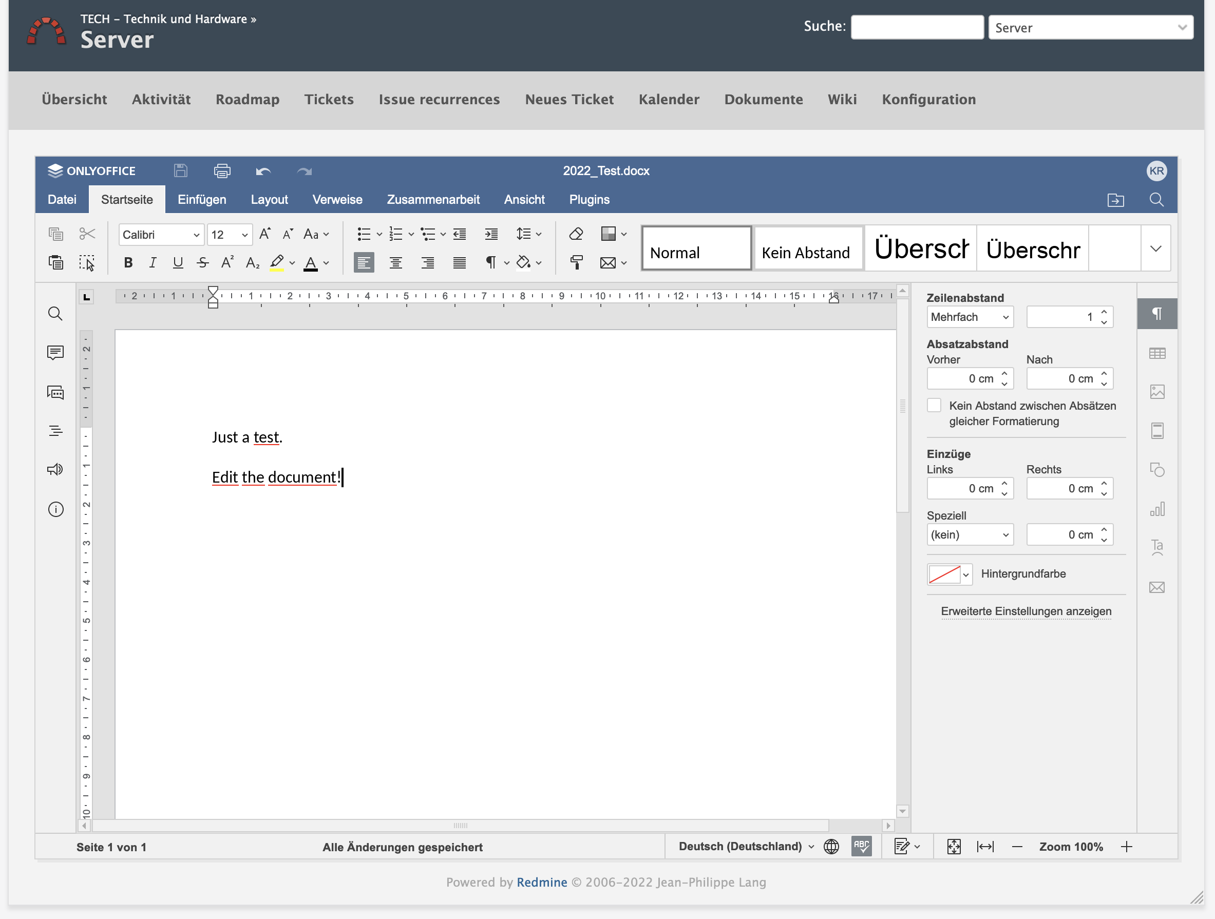

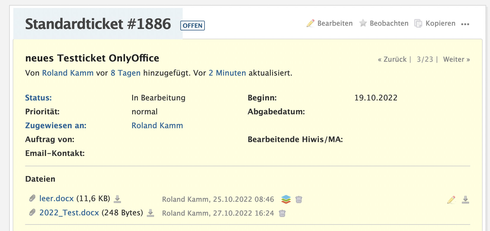

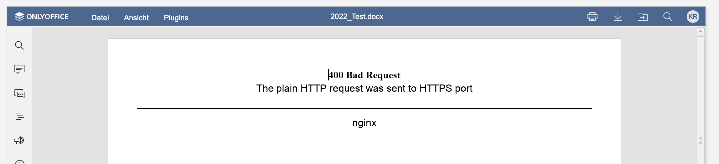

Attached are some screenshots to demonstrate the error. To begin with, I have a ticket in redmine where I have a document attached (2022_Test.docx). Then I edit the document with OnlyOffice (screenshot 2), close the browser tab, return to the ticket in redmine, wait for about 5-6 seconds a do a page reload (screenshot 3). You can see, that the size of the document is now 248 bytes. The contents of the file is shown in screenshot 4.
