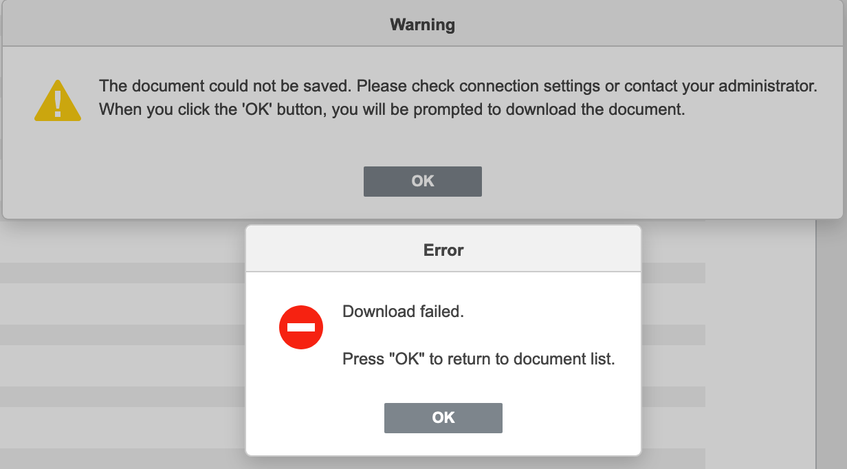

The guide works well without traefik, but when starting traefik and commenting the ports section as shown below, the documents do not load. When creating a new doc in the example page, I’m redirected to a new tab at https://docs.example.com/editor?fileName=new.docx and I get the error “Cannot GET /editor”.
However, I can go back to the example page and open the example document that was created, this opens the editor but the document does not load. Resulting in this error
Please help :slight_smile:

I’d recommend connecting the Document Server to some other service to check the functionality as our embedded example service is not intended to work behind a proxy.
Also please make sure to follow our Traefik example configs for correct proxying to the Document Server:

I’ve had this working using docker-compose.yml and also using a file provider for Traefik (the same rules apply, but using YAML instead of labels for the file provider).
You need to set up some middleware headers:
http:
  routers:
    onlyoffice:
      tls:
        certResolver: "cloudflare"
      entrypoints:
        - "websecure"
      rule: "Host(`onlyoffice.mydomain.co.uk`)"
      service: "onlyoffice"
      middlewares: "onlyoffice-headers"
  services:
    onlyoffice:
      loadBalancer:
        servers:
          - url: "http://192.168.1.12/"
  middlewares:
    onlyoffice-headers:
      headers:
        customRequestHeaders:
          X-Forwarded-Proto: "https"
        accessControlAllowOriginList:
Hope that helps.
