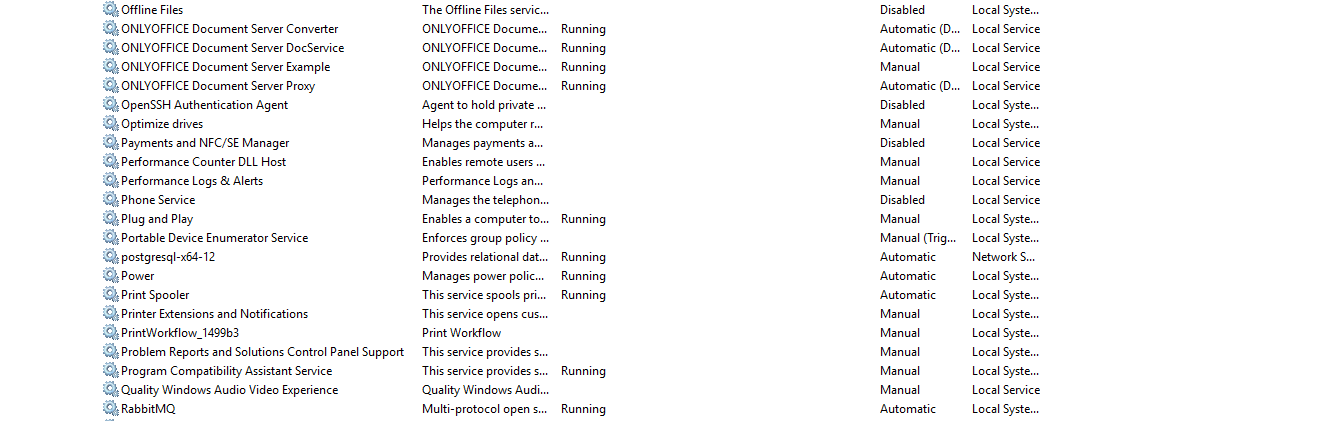

Hello @shaileshbist,
  • Please provide the screenshot of Onlyoffice services statuses within Windows Services

Hi,
Thanks for your response. Screen shot given below
