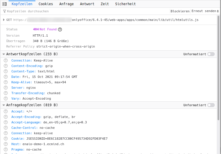

I checked the logs and the only difference I can find is, that is try to load a htmlutils.js file what is not available. The other system does not try to load this file.
2021/10/15 09:05:43 [error] 6262#6262: *26 open() "/var/www/onlyoffice/documentserver/web-apps/apps/common/main/lib/util/htmlutils.js" failed (2: No such file or directory), client: 172.17.0.1, server: , request: "GET //6.4.1-45/web-apps/apps/common/main/lib/util/htmlutils.js HTTP/1.1", host: "enaio-demo-1.ecmind.ch", referrer: "https://<host>/onlyoffice/6.4.1-45/web-apps/apps/documenteditor/main/index_loader.html?_dc=6.4.1-45&lang=en&customer=ONLYOFFICE&headerlogo=https%3A%2F%2F<host>%2Foffice%2Fassets%2Fecmind.svg&frameEditorId=editor&compact=true&parentOrigin=<host>&uitheme=default-light"

The htmlutils.js bug was caused by using the toolbarNoTabs parameter (ONLYOFFICE Api Documentation - Config) and it did not affect the editing anyhow. We fixed this bug in v6.4.2.
I’d suggest checking the editor config. Maybe the mode is set to view, or the permissions are set this way.

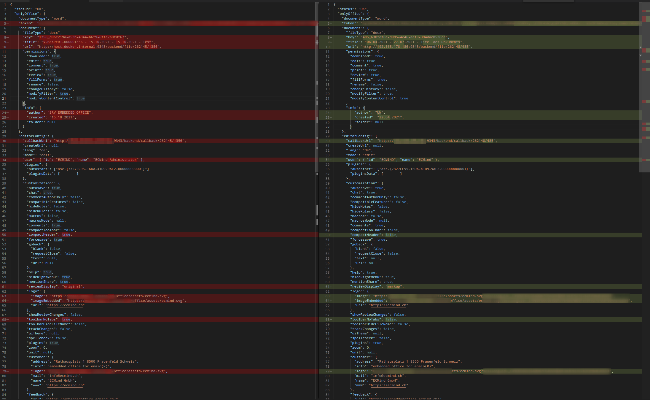

I compared the to configurationss but I can’t find the problem:
Red does not work, green is fine.
I execute my test with the same browser and maschine (firefox).
Config starts at the node onlyOffice at line 3
I found the bug.
reviewDisplay: original is the problem in edit mode.
If it is set to markup, it works. I guess there is a implicit bugfix for this property in 6.4.
This is not a bug. Final and Original mode display the document in viewer:
