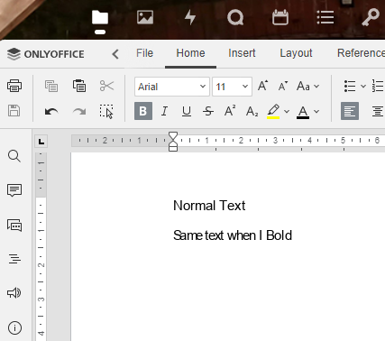

When I open a doc in incognito mode via browser, document is formated correctly, when I open as a logged in user (nextcloud) in the same browser formatting is all wrong. Bold isn’t bold, font isn’t correct font. Any ideas?

I’m not the server admin, it seems to be fine when first installed but started happening last week, it only seems to affect me as a user.
As an example, created a new document (.docx). I typed in the text and then bolded 2nd line

I’ve forwarded to admin, opening the same document up in a different browser seemed to have solved the problem so must be some sort of local user caching? or something…
