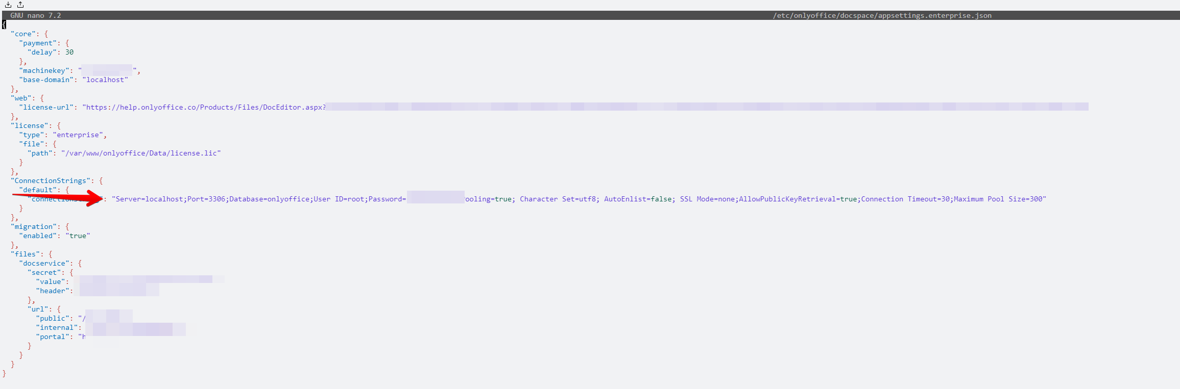

That is for the docker setup and indeed is correct. The DEB package setup does not have .env files. I have yet to test the /usr/bin/docspace-configuration -mysqlp but im guessing that should be the right way to do it.
Ah, I got it. Please check /etc/onlyoffice/docspace/ folder on the host. There should be appsettings.enterprise.json file which contains necessary data, you need the ‘ConnectionStrings’ block.
