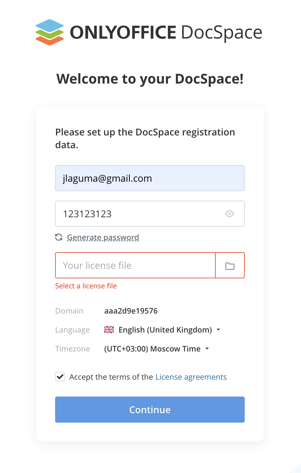

I’ve figured it out myself. But now I have another question. Why is it asking me for a license?
oops
Thanks, @taran, we’ll fix it.
If you copied the repository, change the installation_type in the file: docspace/build/install/docker/.env
INSTALLATION_TYPE=ENTERPRISE >> INSTALLATION_TYPE=COMMUNITY
or when launching the yml file add:
INSTALLATION_TYPE=COMMUNITY docker-compose ?.yml up -d
Thanks Nikolas,
with your tip + few more modifications, I was able to compile everything and get it to run.
