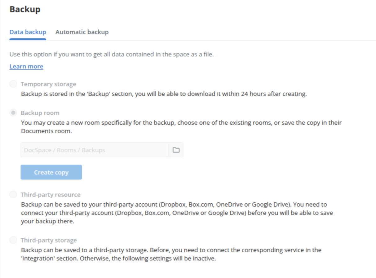

I am running an on demand backup to a room in docspace to hold backup tarsets.
The backup DOES run, but it runs VERY slowly.
The total volume of data in the rooms is only 8.1Gbytes

How slow is it exactly? As far as I know it backs up not only documents, but rooms and other files too. What is the total size of a backup that you’ve made previously?
Hi Constantine. happy new year. backing up docspace is NEW to me. There are 25 rooms (or so) and only 9G of data across all those rooms so I’m surprised it’s slow. Where can I get metrics I can share with you perhaps?
thanks
Thanks. Happy New Year to you too.
I’m not aware of such, that is why I am asking how long it takes in your case. 9Gb of data is already a significant value, but it also backs up rooms too. On your screenshot, rooms take 33 additional Gb.
