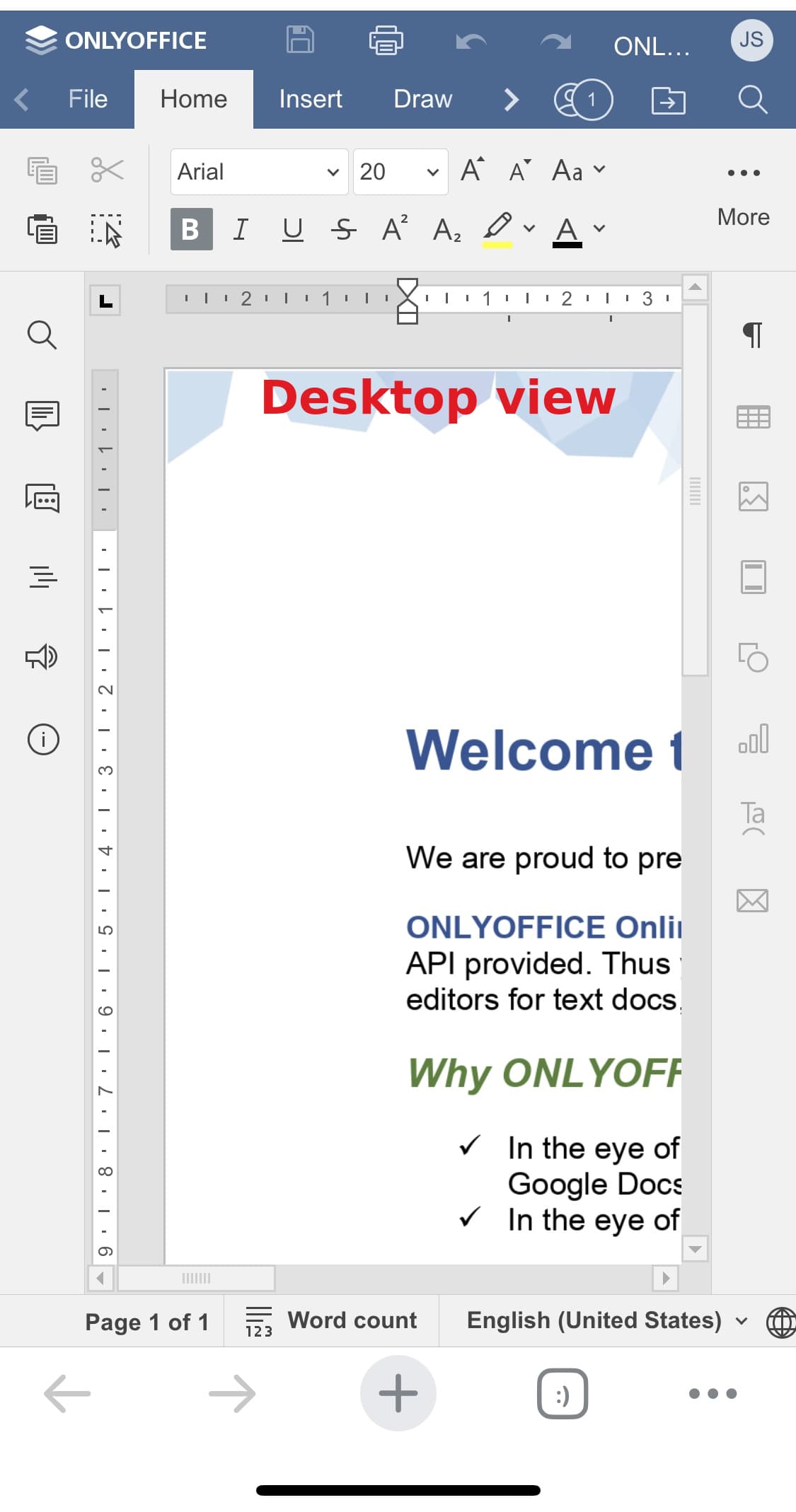

Hi, we use OnlyOffice. And we use API to set mode on viewer.
If mobile we send “type: ‘mobile’” and if desktop, we send desktop.
But sometimes the mobile view is very bad.
Like we have a toggle button in mobile view to show desktop view. I ask me if they are not a parameter to send in API to set by default the desktop view on mobile. And if click on toggle, back to mobile view ?

Do you mean using the Standard view by default when opening on mobile devices, or is it the opening in the full-size editor window (Desktop view)?
Hi Nikolas ! Thanks
On mobile / tablet i want to show standard view (like your 2nd capture). And have possibility to toggle to mobile view (like your 3rd capture) if users want to do it.

Oh, as far as I know, it’s not implemented yet…
It’s planned to be introduced in version 7.6.x.

By default, mobile.standardView is set to false:
https://api.onlyoffice.com/docs/docs-api/usage-api/config/editor/customization/customization-standard-branding/#mobilestandardview

How to get that standardView set to true on an OnlyOffice installation via NextCloud?
@petervanwesten
Unfortunately, this option is not yet implemented in the ONLYOFFICE integration app for Nextcloud.
Thank you for your feedback — I’ll make sure to pass it along for consideration.
