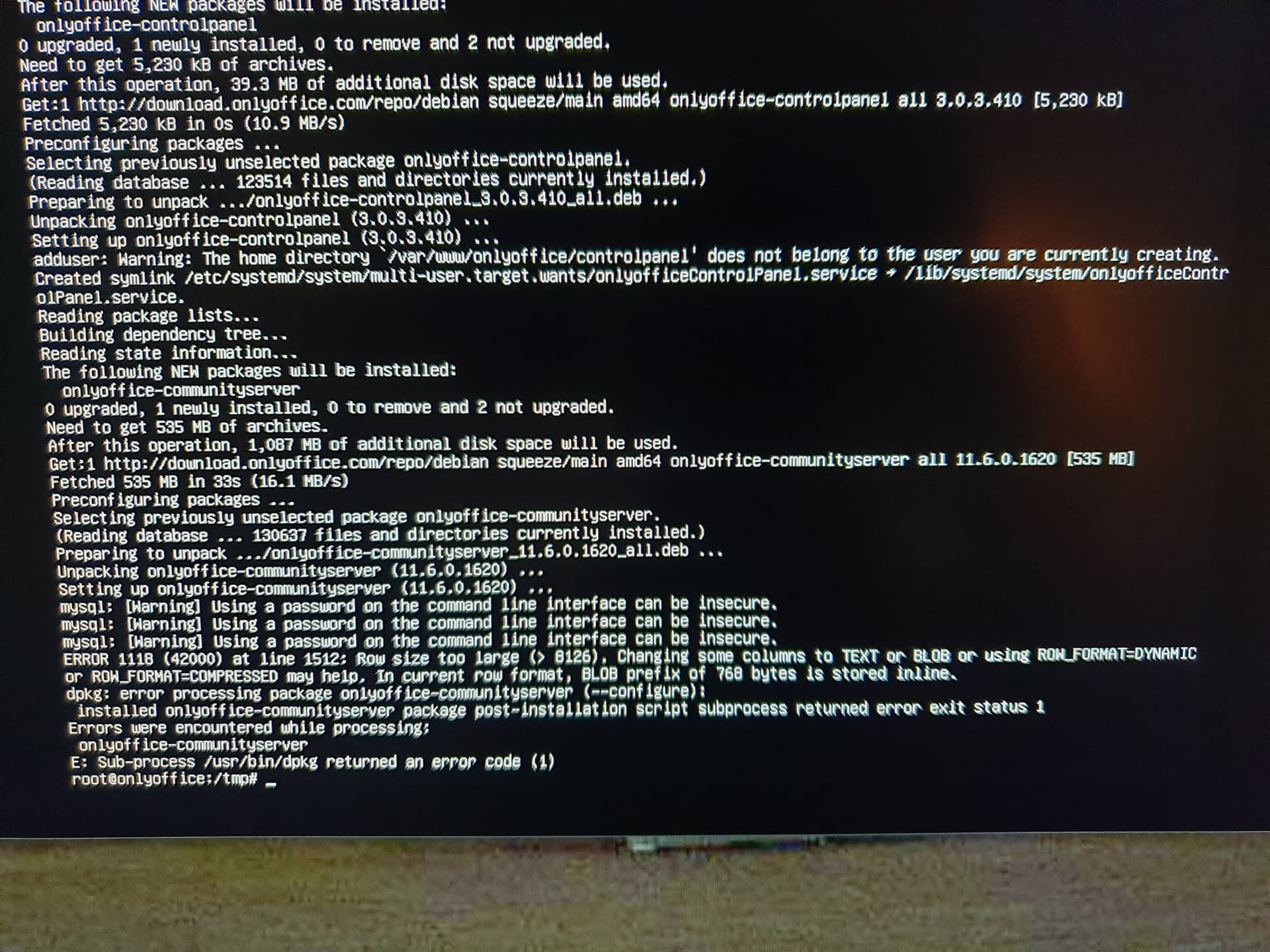

I have a clean install of Ubuntu 20.04, SELINUX not running.
I follow the instructions here using steps 1 and 2.
https://helpcenter.onlyoffice.com/installation/groups-install-ubuntu.aspx
The install fails while MYSQL is being accessed to configure the communityserver
mysql error log attached and screen shot of failure point during the install.
Its connected to this issue with how Onlyoffice is using MYSQL
Help appreciated.

2022-04-28T18:45:34.085614Z 10 [ERROR] [MY-011825] [InnoDB] Cannot add field introduction in table onlyoffice.mail_mail because after adding it, the row size is 8607 which is greater than maximum allowed size (8126) for a record on index leaf page

Hello Ivan,
Sorry for the delayed reply.
It seems the issue is caused by the version 8.0.29 of MySQL. With the version 8.0.28 installation goes correctly. Please try this to avoid the issue:

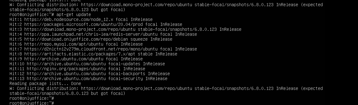

apt-get update followed by apt-get upgrade because of the MONO sources entry
https://www.mono-project.com/docs/getting-started/install/linux/
Are OO locking the versions of Elasticsearch and Mono in the repo files you distribute to stop those packages creeping away from validated / supported versions?

W: Conflicting distribution: Index of /repo/ubuntu stable-focal/snapshots/6.8.0.123 InRelease (expected stable-focal/snapshots/6.8.0.123 but got focal)
root@onlyoffice:~# apt-get upgrade
Reading package lists… Done
Building dependency tree
Reading state information… Done
Calculating upgrade… Done
The following packages have been kept back:
elasticsearch fwupd
0 upgraded, 0 newly installed, 0 to remove and 2 not upgraded.
Hi @ivan,
Please accept my apologies for the delayed reply.
You can ignore this warning, it won’t affect updating other packages in the system.
