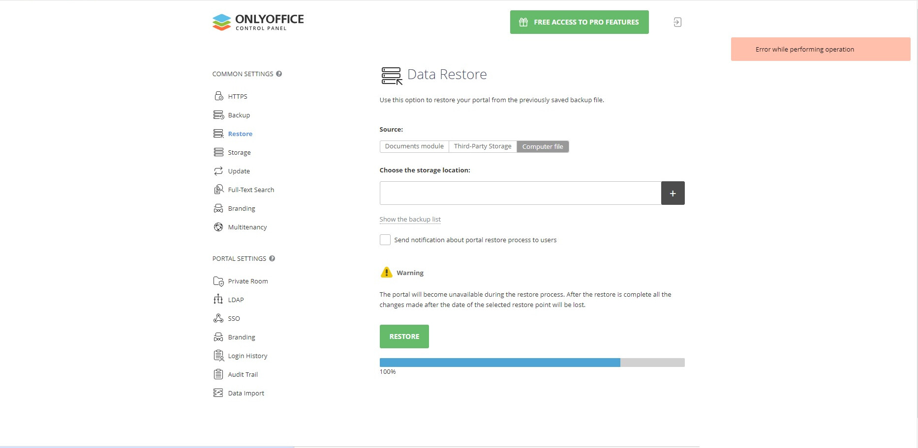

Data restore error
Community Server/Control Panel version: 12.5.2.1848/3.5.0.516
Type of installation of Workspace (docker, deb/rpm, exe): Docker
OS: Linux Ubuntu 22.04
Browser version: Chrome, Firefox
Hi Masters!
Given 2 pcs on which linux (Ubuntu 22.04) is installed, and running Onlyoffice Docker versions.
I followed the official given instruction: LINK
Everything works fine, BUT the backup process on Control Panel runs successfully on PC1. On PC2 it says an error when restoring: “Error while performing operation”
Everything is the same between the two machines: Onlyoffice version, Control Panel,Docker, OS … but it still gives an error. :neutral_face:
Has anyone encountered this kind of error because Google can’t find any information about it either?
Thank you!
Regards: DrCyberg
Hi @DrCyberg :wave:
Could you please send the following logs of the community server (path: /app/onlyoffice/CommunityServer/logs ):
  • svcBackup.date.log (with the dates when the issue occurred)
  • web.date.log (with the dates when the issue occurred)
  • web.api.log
Send us also a screenshot of the page with opened browser’s console (choose Network tab in browser’s console) and reproduce the issue again, so the information in browser’s console is shown.
(you can send me in PM)
