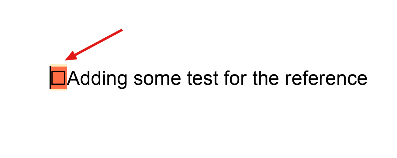

var oRange = oDocument.GetRange(0, 0);
oRange.SetShd("clear", 255, 111, 61);
Here I’ve used SetShd and CreateCheckBoxForm methods for the reference.
The check-box form created with CreateCheckBoxForm method can be selected within Forms. You can test it out by creating an OFORM or DOCXF document, adding this form then going to Forms tab on the main toolbar and pressing View Form button.

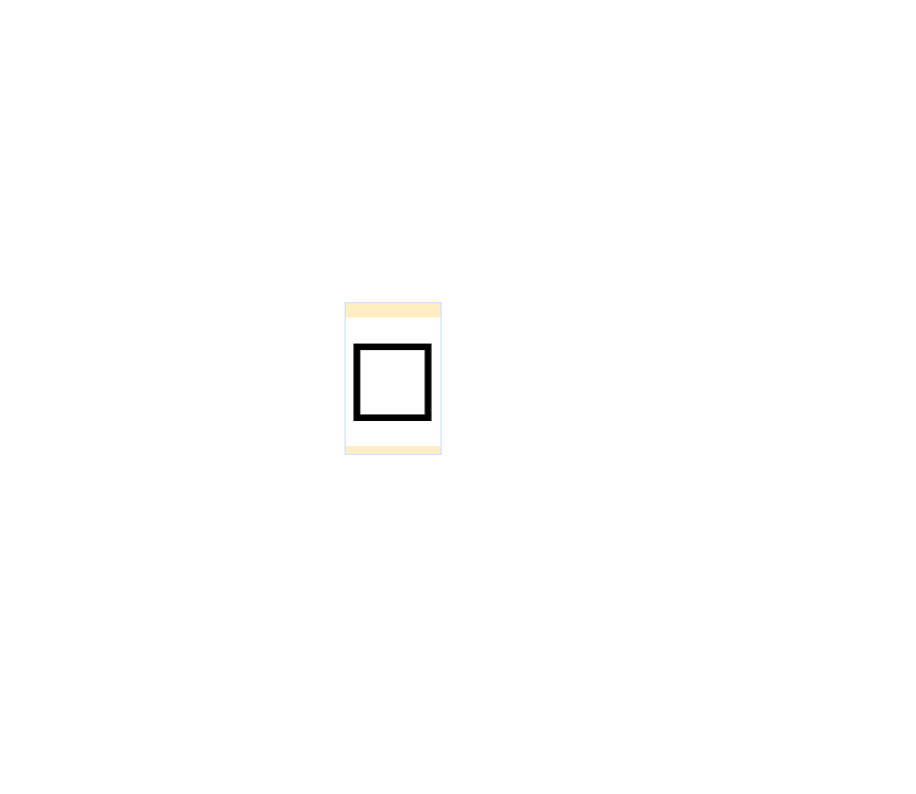

Thanks for the reply, I still have the background color issue using the example builder code as shown in figure
Please note that checkbox form created with method CreateCheckBoxForm is a part of Forms API, it will be always highlighted as a form that can be filled.
If you are developing a plugin, you can insert Content Control check box with AddContentControlCheckBox method.
