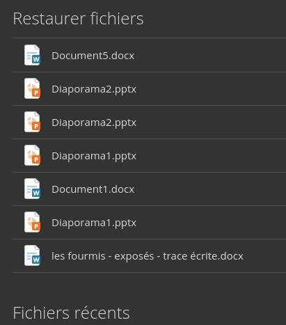

When it crashed, the opened filed where these:
Currently I’m using ONLYOFFICE version 8.3.2.19 (flatpak) on linux mint (up to date, last version)

Please clarify the exact Linux Mint version and if the issue is still reproducible with files from screenshot. If so, could you please provide us with these files?

Uhm… you might have read my post too fast :smiley:
I joined the files the line above the screenshot :slight_smile:
